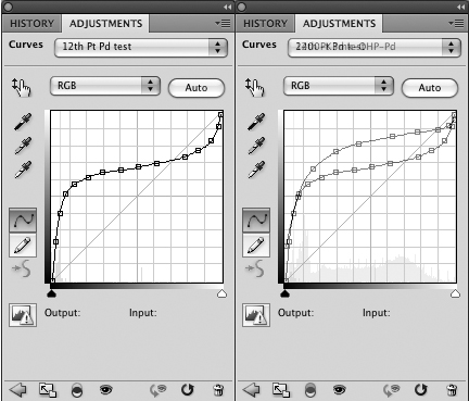

I'm attempting to make some digital negatives for Pt/Pd using 12+12+1 @ 2.5% Na2, a Nu-Arc 26-1K plate burner, Pictorico OHP, and an Epson 2400 printer. I'm getting exposure fog using the semi-gloss setting, and Photo Black ink w/color inks in the Epson print driver. A Stouffer stepwedge indicates I'm getting a 1.5 density range with the chemistry and exposure.
Is anyone using the Epson 2400 driver to make successful negs for Pt/Pd? If so, could you suggest some settings and perhaps post a curve?
It has been several years since I made digital negatives and then I used an Epson 2200 and made negatives for Van Dyke prints. I assume the resultant prints needed a spectrally denser negative due to the longer exposure scale of VDB. I've tried screening the negative with the same color (and others) that I used for VDB, but I still get fogging.
After various tests it seems I'm approaching the curve posted on Ron Reeder's website, but his curve is for using QTR and matte black ink. I've overlain that curve with my best attempt so far at right in the image below.
Thanks for any help.
Joe
