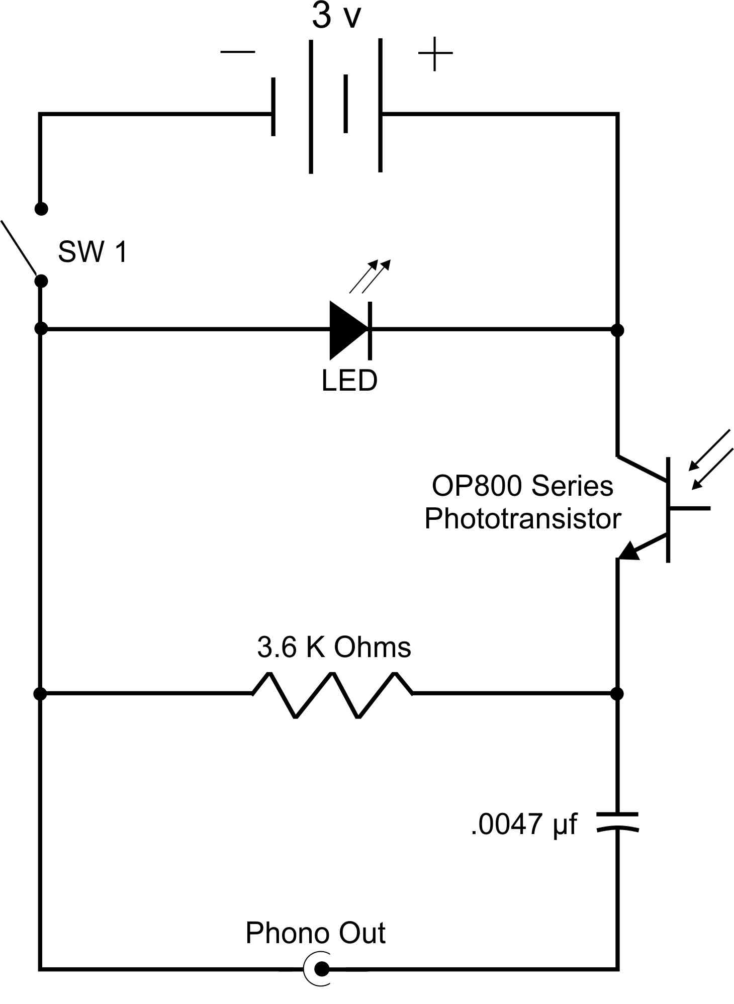

I use a similar one, also photoresistor based, for the PC sound card audio input.
Audio inputs usually have a capacitor in series, so it displays a weird curve that anyway is useful to calculate speed.
Personally, I ended capturing the signal with an usb oscilloscope, displaying a nicer curve that is also useful for diagnostics as both the openning and the closing flanges are well displayed.
Circuit is usually quite simple.

I am using this app and built my own photo-plug (it's essentially a photo transistor, see post #5). I am happy with it and down to about 1/200s it seems to work well. I use this whenever I get a new lens and base my exposure on the corrections derived that way.
You can use the app w/o the plug and that it just records the sound your shutter makes. The problem with that mode is, that I found nearly impossible to correlate the actual time the shutter is open with the acoustic wave form.
