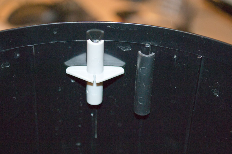

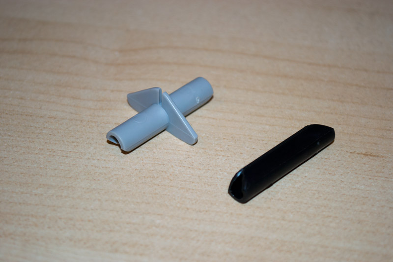

A thought. My print drums came along with 2 different varieties of clips. I never used them. I attached a picture of the clips and another of the clips installed in the 3062 expert print drum just for demonstration. I assumed these ar for help in positioning the paper in the dark, although the function of the one with a triangular shape has always excaped me. I'm now wondering if the circular clip could serve a similar function for film??
