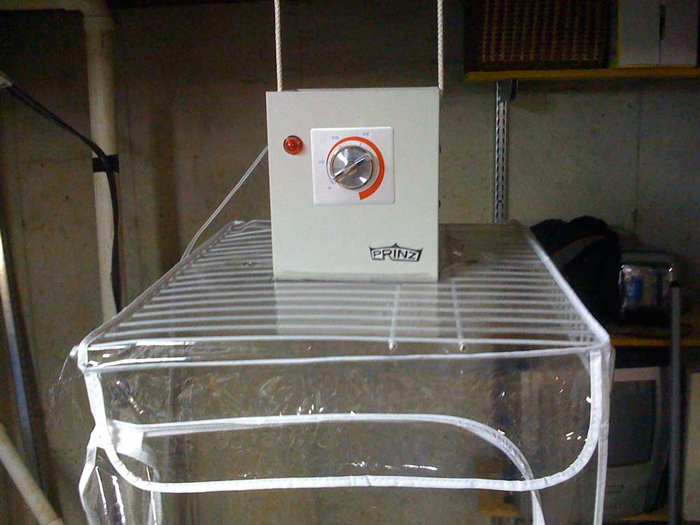

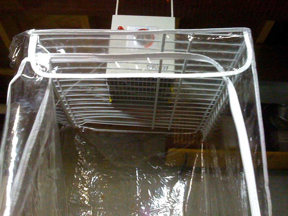

I took an approach similar to that of @John Powers; I took the operating fan/heater head unit from an old Prinz film dryer and cleaned it up. I got this on eBay, cheap. I replaced its filthy filter with furnace-filter material from Lowe's---thin sheet kind, also cheap.
I took a piece of Closet Maid shelving material and cut it into a square the same size as the square cross section of one of those plastic clothing hanging bags you can get at Target or elsewhere. The shelving acts as a frame; the clothing bag replaces the Prinz unit's ripped, brittle, yellow original drying "sleeve." The shelving square goes into the bag against the square end, into which I've cut flaps to form a hole the size of the Prinz head. So the head sits atop the bag and blows warmed filtered air into the bag. I've cut a drip/air exit hole in the bottom of the bag. The whole thing is thus a positive-pressure bag to keep dust to a minimum while the film dries more quickly than drip-dry alone.

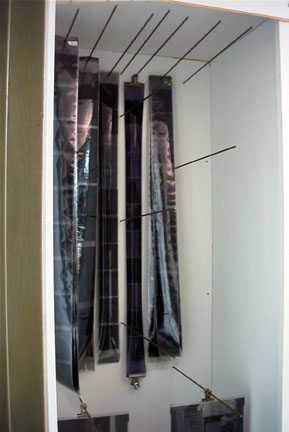

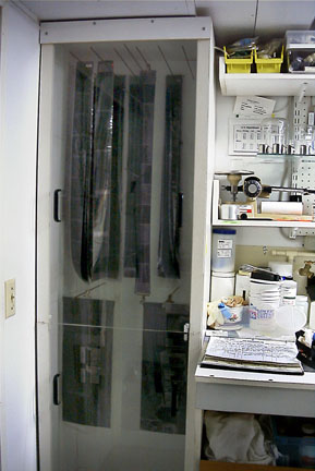

It's 18x20x76" high, has 2 sheets of 3/6" plexiglass doors, and a series of 3/16" brazing rods projecting from the back wall for hanging film. I just finished developing 30 rolls of 220 film (they're cut in half and sleeved), and a couple of 8x20 negatives. The brazing rods are arranged so I can hang a lot of 4x5, 5x7, and 8x20 films without them dripping on each other.
I have a simple heating pad on the floor to bring up the temperature on humid days. No fan... I don't want any air movement inside that chamber.
When I have a lot of film in the cabinet, drying takes longer and the film doesn't curl as much.
That cabinet has a downside... I tend to use it as a temporary storage closet untill I can get around to cataloging my films... it kind of happens when you develope tons of film and not enough time in the day...

I've cut a drip/air exit hole in the bottom of the bag. QUOTE]
Reading Mike’s description I remembered that I dealt with the few drips by covering the bottom of the closet with paper towels. I wasn’t sure what the bottom material was and if it would hold up to water. The paper towels absorbed most of it and then dried with the film. Maybe I ought to change them now that they are at least four years old. High maintenance.
Thanks Mike and Dale (ic-racer)
John
