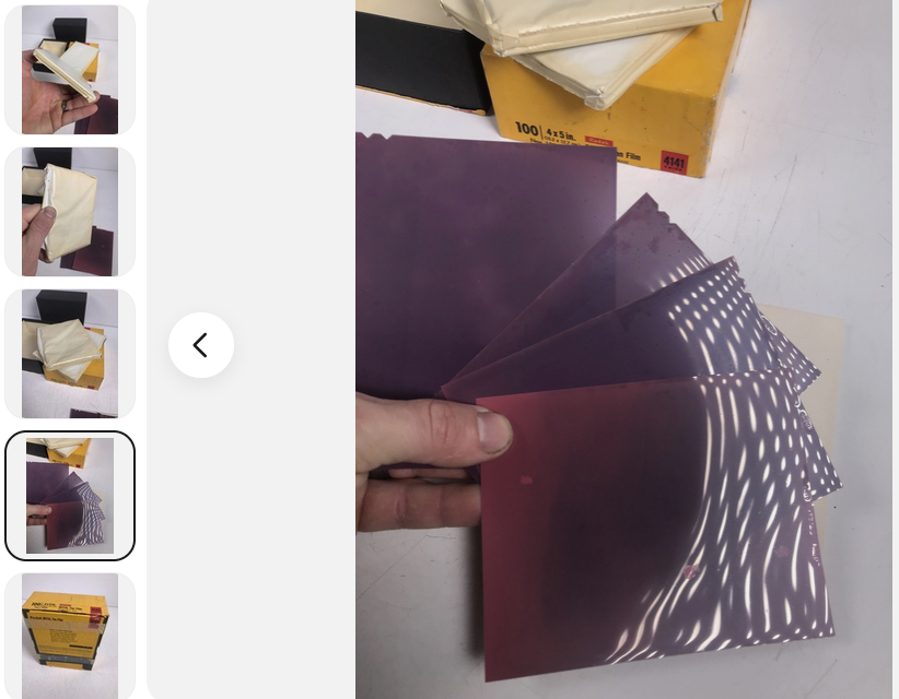

Wow there's heaps of it on ebay. I'm looking at this one. Should I get it? I'm a little worried about the potential of high base fog though... 😄
