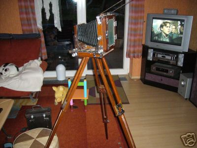

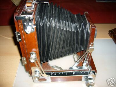

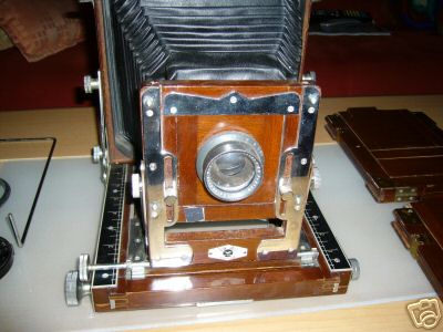

Just bought this cheap.... i hope :wink:
It comes with a Leitz Tessar 210/6.3 and 4 film cassettes, tripod and a leather trunk.
Does anyone have any information on this camera ???
Thank you to anyone who are kind enough to spend a little time explaining.... much appreciated.
Claus / Denmark

Looks like a Japanese 1/2 plate camera. Could be English though. Early 20th century. Nice little camera, regardless.
If it's a Leitz Tessar it almost certainly is Japanese....
(Sorry, couldn't resist).
The f/6.3 Zeiss Tessars are among my favourite lenses: MUCH better than the faster versions. As you say, the size and f.l. indicate half plate/13x18cm/5x7 inch.
Cheers,
R.

Dear Claus,
Very fair price, I'd say, with that lens (assuming it is a Zeiss Tessar).
Further information? No. It's too generic. The anodized scale along the edge suggests recent Chinese/Japanese to me (within the last 30 years) but the non-standard film-holders argue against that. There's a Russian camera that looks somewhat like this, and has non-standard holders, but my recollection of it is not that clear. The lens has to be worth 50-100 euros which leaves 73-123 euros for the body and four film holders, something of a bargain.

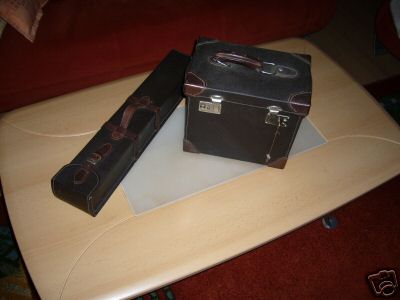

Maybe these additional photos will help you guys out....
But to narrow it down, you suggest it is 13x18, of Japanese or russsion origin
Any feedback that will narrow it further down to its content - is most welcome

Almost certainly Russian then. All I can suggest is googling Russian 13x18cm cameras. I have handled them but have never seriously considered buying one - though at that price, I might have.
Cheers,
Roger
