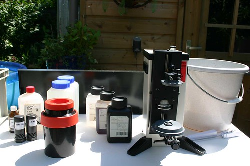

2521 (red lid), without elevator, 270ml. (Magnet coupling)
2523 (cog wheel), with elevator, 270ml
2502 spiral, 1x 135-36, 1x 220 roll film or 2x 120 roll film. 127 also possible.
Especially for C41 in rotary use the 2500 series tank. For precise C41 (and E6) development use the elevator because 3:15 minutes CD, must be accurate.

Without elevator you have to use the magnet. With elevator you use the cog wheel. This wheel fits into the elevator wheel. Up from the elevator you can fill the tank and empty the tank (to waste).

The cog is for use with a lift (which can be applied to a CPA or to a CPP) and is applied to the lid.
The magnet is on the bottom of the tank if I understand well, so it can remain on the tank and you can use the same tank with a normal lid in a Jobo without lift, and with a lid to which a cog was applied with a Jobo with the lift.

For C41 the 1520 is not very good. You will get uneven development. Further you have to adjust the roller base for 1500 series too. They are smaller.
The 25XX series has been designed for rotery development. Without elevator you need 2521 (red lid) + one or two 2502 reels and a magnet nr. 1504.

The magnet is the original method of attachment of a tank to a Jobo processor. It is sitting at the bottom of the tank. The processor has a corresponding magnet coupling which is also used to drive the tank.
When you convert your processor to a lift, you remove the processor magnet and install a gear system to drive the tank. The tank is then put front first into the lift and when you lower the lift, it couple with the gear on the processor to rotate. The tank has, also to be converted to this use (I. E. have the corresponding gear on it's cover, be it from factory (reference # ending in 3) or added after sale (reference # ending in 1). In the later case, remove, if you can, the magnet to reduce the processors motor strain....
