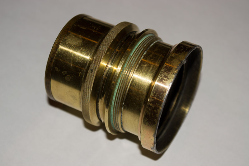

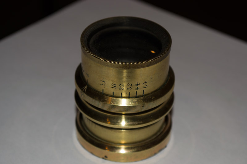

I just "inherited" a brass barrel lens. I have no idea of the focal length or of it's coverage. It has very few markings apart for the aperture scale. There is a VIII engraved on the barel. There are 2 elements (maybe groups?, I can't tell if there is more than one piece glass glued together). Any info would be appreciated.

In the first two phototos the sets of cells are mounted at the wrong end of the barrel, the wider set has a slight lens hood built in and should be at the front leaving the smaller diameter set at the threaded end.
There were an awful lot of unmarked R-R lenses made in the late 1900's, some by larger companies others unknown. Finding the approx Focal lenght is easy just focus a tree or something distant onto a piece of paper and measure the distance of the aperture ring to the paper.
Often these R-R lenses had relatively long FL's so the one on my half plate camera is marked Wray 8"x5" (coverage) with a S.No. there's no FL marked but it's actually a 300mm/12" f8. Aside from the aperture scale there's no other markings on my 6" lens on my quarter plate camera.
Thesew lenses are ideal for using with a Thornton Pickard shutter, they came in two types one for front mounting the other between lens board and lens.

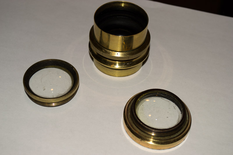

Thank you Ian. I had not noticed but of course you're right that one end has a small shade that even has what seem like filter threats on the inside. This end surely belongs on the front of the barel. This has obviously been played with before getting to me. I also note that the rear element is placed convex facing away from the diaphram while the front element is facing convex in. The diagrams I've seen showing the elements in a rapid rectalinear lens always show the convex side of the element facing out. Any ideas?

I finaly mounted the lens on a board and tried it on my 4x5. The lens projects a very bright image. I measured the focal length at about 210mm. This is consistent with the focal length as calculated by the diameter of the diaphram at a given f-stop. It also projects a very large image circle. With maximum shifts and rise/fall I could not reach the end of the image circle at f/8. Saw the edge with front swings and tilts of course. I estimate the coverage that I could verify at about 8 x 8 inches. I want to use it on my Century Universal (once I finish rebuilding it), and I'm hoping it will cover the whole 8x10 negative stopped down to f/32-64. My fingers are crossed :smile:

hi pasto
when you removed the elements
was it just a barrel or were there elements inside the brass barrel ?
rapid rectallinaer lenses have the curved part of the lens cells facing OUT
( there is a diagram in the links i posted before ).
good luck !

There was no lens inside the barel, just the front and rear. And the groups are identical. Also, after looking at both groups carefully I can see there is some yellowing film on areas on the inside of the group. I suspect this is probably the adhesive for the two elements in each group. Yes John, I figured that the elements were both convex out from the diagrams I saw. I'll expose some 4x5 TMX tomorrow and see.....
