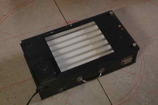

While buying some darkroom equipment from a professional photographer a couple of years ago, I had asked if he had a light box he would part with. My wife was needing one and if I found one then I could borrow mine back. Anyway, what I ended up with is called a "Portable Transparency Printer" by Mfg Charles Beseler Co.
She said it was way to bright and gave it back to me. It is to much for looking at negatives. I am wondering if it is used in some process that I am not familiar with. Burning plates? It uses fluorescent bulbs with mirror like reflector.
Any uses?

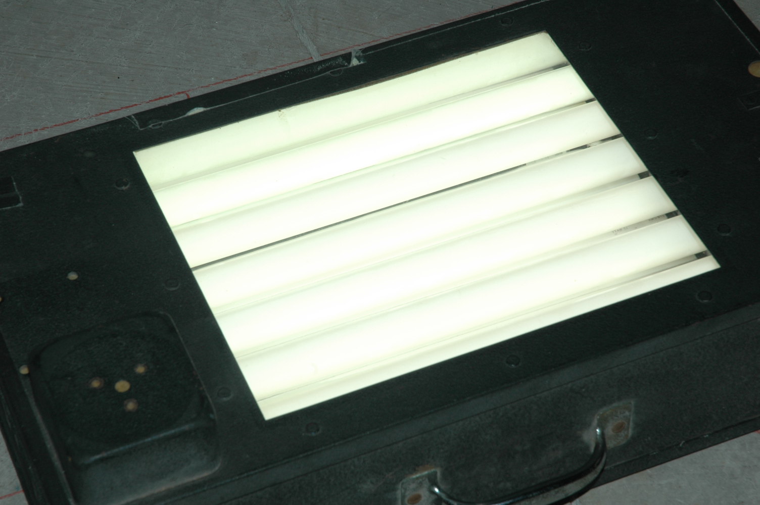

Would this be useful for a large format contact printer? The bulbs come on very fast. Very bright.

This is not a light-box for viewing. If it is like mine, the pressure plate arm was removed from the top.
The bulbs are a source of Ultraviolet light and can damage your eyes. This was designed for exposing print-out paper and other emulsions that require intense light. This is too intense for projection speed paper. I am using mine to contact print cyanotypes.
Pp
John51
May 18, 2014
797
It looks like the boxes that get used for exposing printed circuit board prototypes. Also for some forms of letterpress plates.
