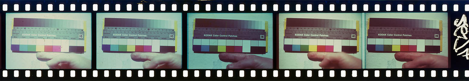

With great difficulty I found the test with color positive processed as reversible color.
These samples are now 19 years old.
It is not very good, but it seems that it is photographed.
That's my finger.
There are several exposures shooting conditions:
1. Exposure / diaphragm 1/60 2.8 + 3 (three) filters Wratten 85;
2. Exposure / diaphragm 1/60 1.8 + 3 (three) filters Wratten 85;
3. Exposure / diaphragm 1/60 4.0 + 2 filters Wratten 85;
4. Exposure / diaphragm 1/60 2.8 + 2 filters Wratten 85;
5. Exposure / diaphragm 1/60 1.8 + 2 filters Wratten 85;
Fogging with strictly red filter - 1/30 at 210 lx without the photo objective at Opemus light;
Superposition of photogrames was not perfect.
Between the first two frames to lick written (test number) looks like a small displacement portion.
Green stripes that are seen are to the lack of exposure to fogging,
The two exposures were not done exactly.
I photographed, I removed the film, I loaded up the film and I exposed fogging.
George
