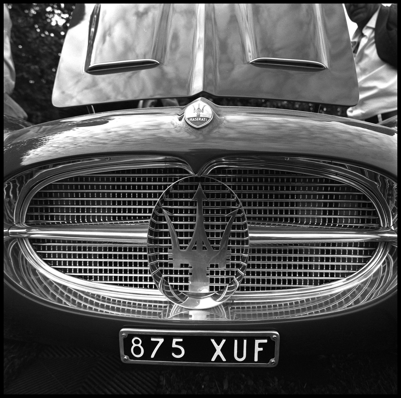

I have a chrome-lens SWC that I use frequently. I've got the diagram that shows the difference in view between the viewer and the taking lens, which is a big help. I like to use the camera with a focusing handle, sot of like a big, fabulous point-and-shoot.
Here's a shot of the polished grill of a classic Maserati, shot last Fall, Ilford Delta 400 in 510-Pyro:
