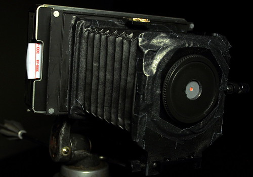

I agree, I would process it through a pack film back. You could just use a changing bag and move the pack into a camera to process it. You will probably get uneven results doing it another way. Some models of pack film cameras can be found very cheap. You could even bust the lens out of one of those cheap cameras and replace it with a pinhole.
This is the pinhole camera I cobbled together with spare parts but I had a pack film back that Wes simple to add to the camera.
PPPF Camera by Bryan Chernick, on Flickr
Some photos taken with it here: https://www.flickr.com/photos/60348236@N07/albums/72157679704766143/with/34028312932/

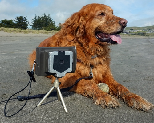

As noted above, a Polaroid "colorpack" or "colorpack II" or "III" or "IV' camera can be had for less than $5. You'll pay more for the shipping than for the camera. It is possible to use the pack in a pinhole camera and then move it back into the camera for processing. You can do it in a changing bag or in the dark. This is probably easier to do if you have some experience with the film and have a sense of how it should feel when it's in the camera correctly. It might be a recipe for wasting film otherwise. You can also make a pinhole camera pretty easily by chopping off the front of one of these plastic cameras and installing a pinhole. Very fun!
Here are some photos made with it: http://www.ipernity.com/doc/nedl/album/658465
