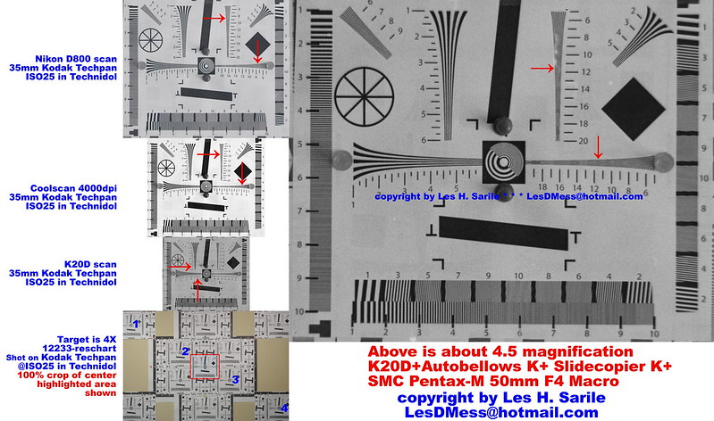

Bought super cheap on local listing - SMC Pentax-M 50mm F4 macro lens, and I was noticing just how sharp the results I was getting from it. I was curious just how much can it resolve. So I tested it using Kodak Techpan @ ISO25 developed in Kodak Tehnidol at all apertures and scanned it using DSLRs 14.6MP K20D, 36MP D800 and my Coolscan 4000dpi as well as optical magnification. The Pentax K-1 you're using also has the same pixel count as the D800 and the Adox may be comparable to the Kodak Techpan.
Full target at bottom left and 100% crops from the DSLRs and Coolscan above it. Since the D800 is the equivalent of about 5200dpi, it results in larger crop compared to the 4000dpi from my Coolscan.
As you can see from the optical magnification crop on the right, clearly the lens can capture far more detail onto this film then can be resolved by these methods I used. I don't know how the Olympus Pen D will compare.
Resolution testing my SMC Pentax-M 50mm F4 macro lens by Les DMess, on Flickr
Of course this was done under very controlled conditions using high res test target intended to out resolve the system being tested. At this point I'm not even sure if my cheap lens was the weak link!

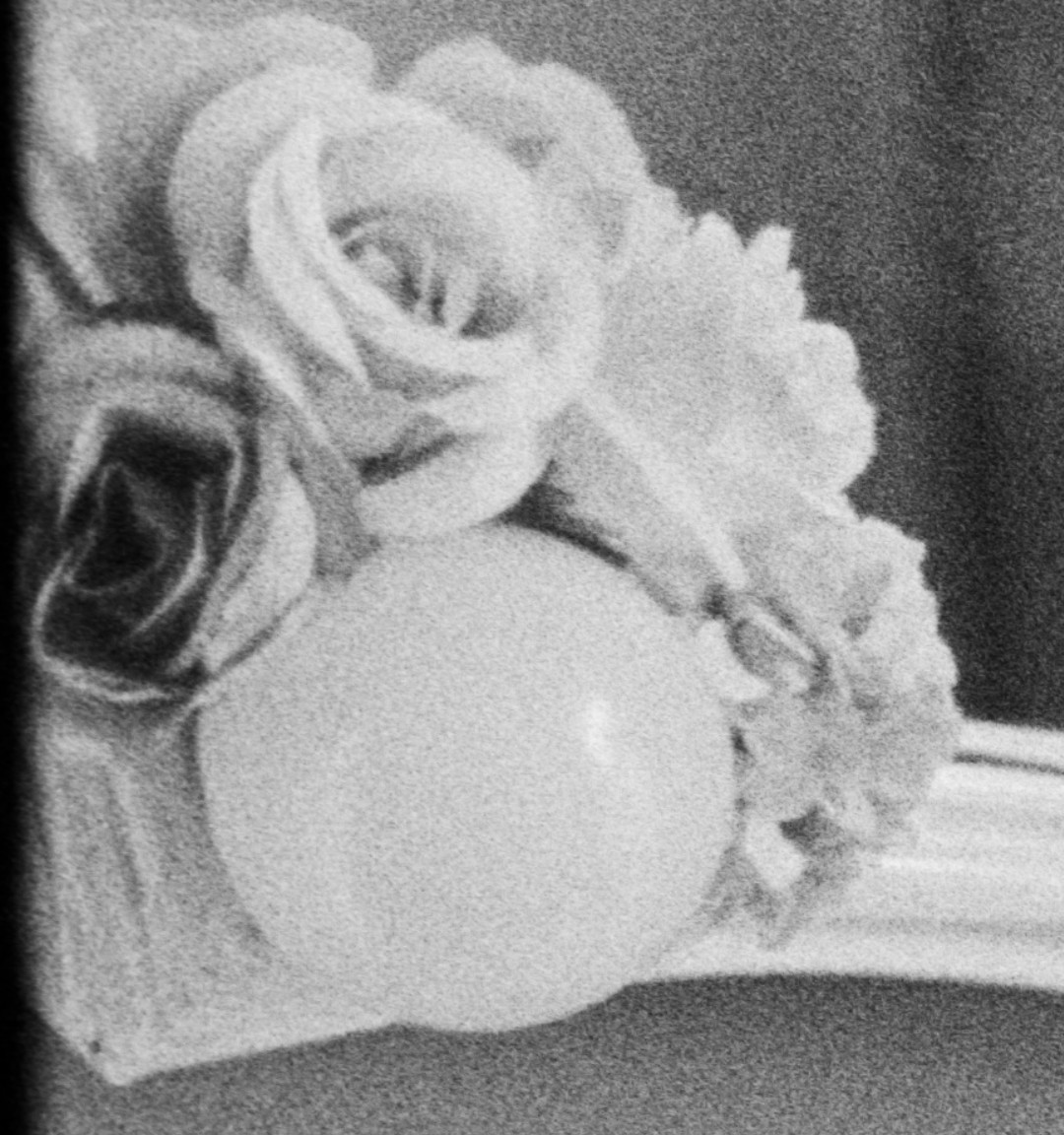

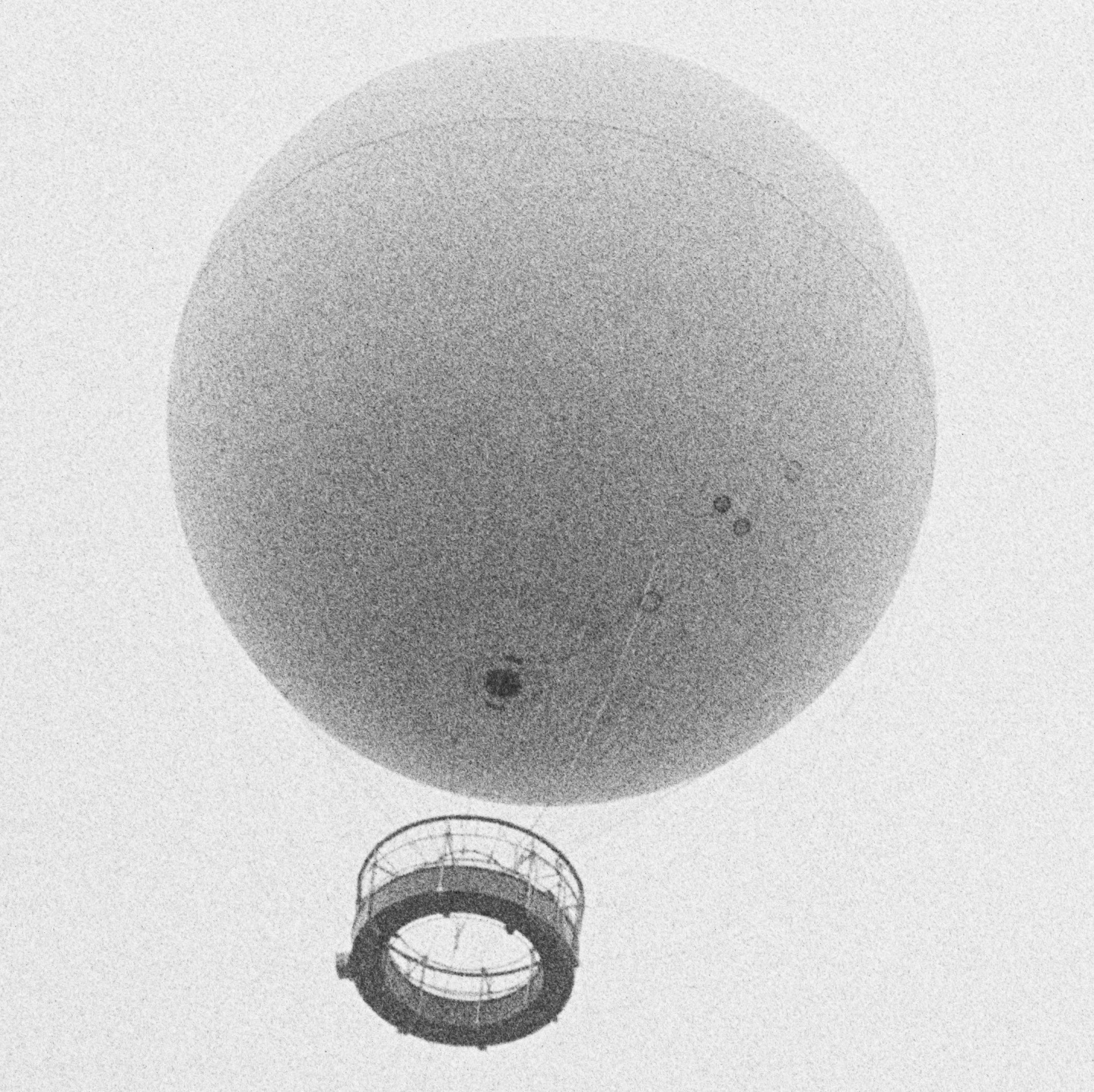

I'll post the Scala 50 results with extension tubes in a couple weeks. In the mean time, here's a 7x7mm crop of the Delta 400 at 800, at 1:1 without using the tubes, with the Pen D set to f/5.6 and 1/500.
Grainy due to the film and 1-2 stops overexposure, but I can see more potential detail from the lens hiding there.
Hell yeah, looks amazing! I suppose this sharpness must come from near the centre of the negative? Even so that's really impressive.

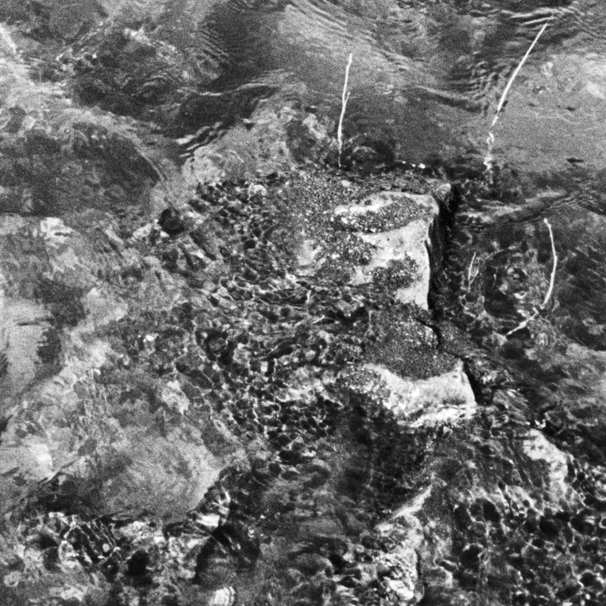

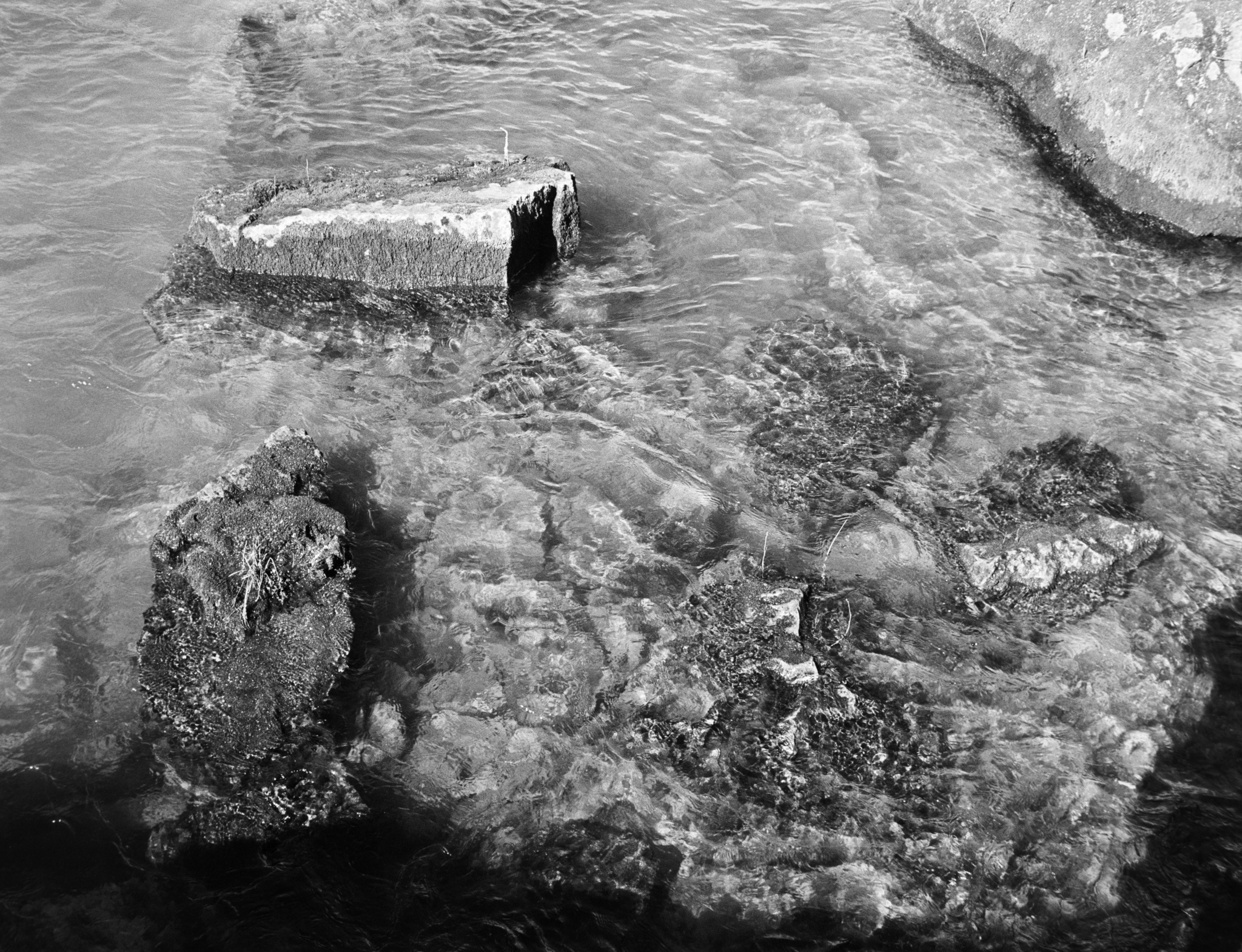

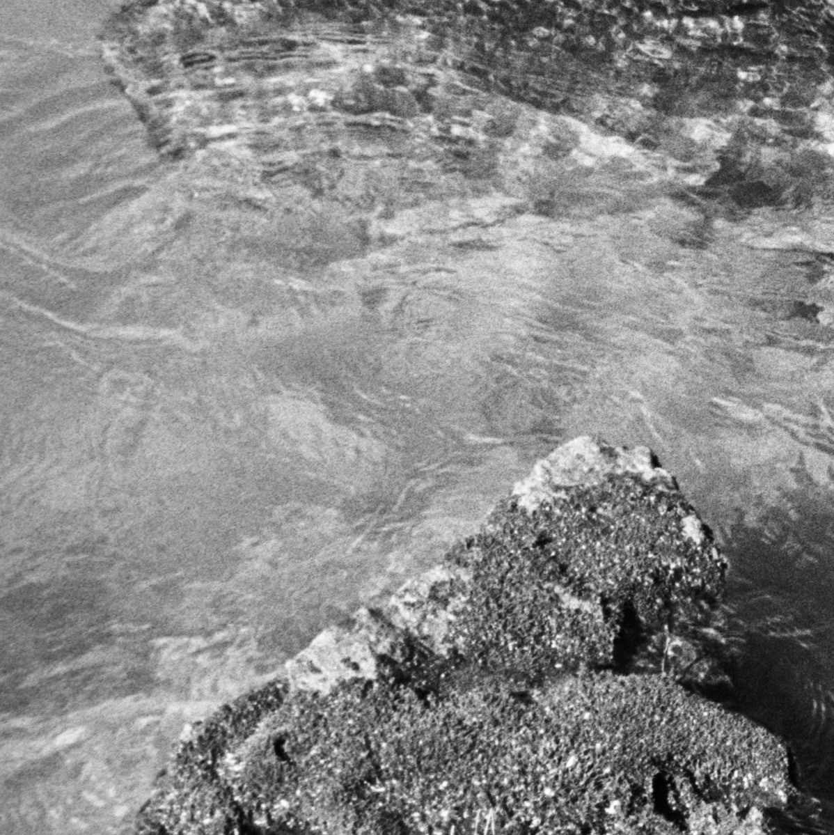

I finally shot and developed some Adox Scala 50 in my Olympus Pen D with Rodinal and digitized it at 1.3:1 with a 20mm extension tube at f/8. Here are some early results.
20x16mm crop from 24x18mm (f/8 1/125):
4x4mm crop near center:
4x4mm crop near edge:
My conclusion so far is that at f/8 the Pen is able to lay down an image just about around the limits of my ability to extract the detail with around 7000 pixels on the long side. I haven't yet determined whether digitization at f/5.6 will help the resolution a bit more. But I suspect I'm pretty near as good as I can get with the limits of the Pen's lens.
The Pen is already in diffraction limited territory at f/8. Try shooting it at f/4 or so.
loccdor
loccdor
Jan 12, 2024
2,384
USA
I couldn't see a resolution difference on the Pen within the range of f/4 to f/8, probably because I need to try digitizing it at a wider aperture, I forget exactly to what degree extension tubes increase diffraction effects.

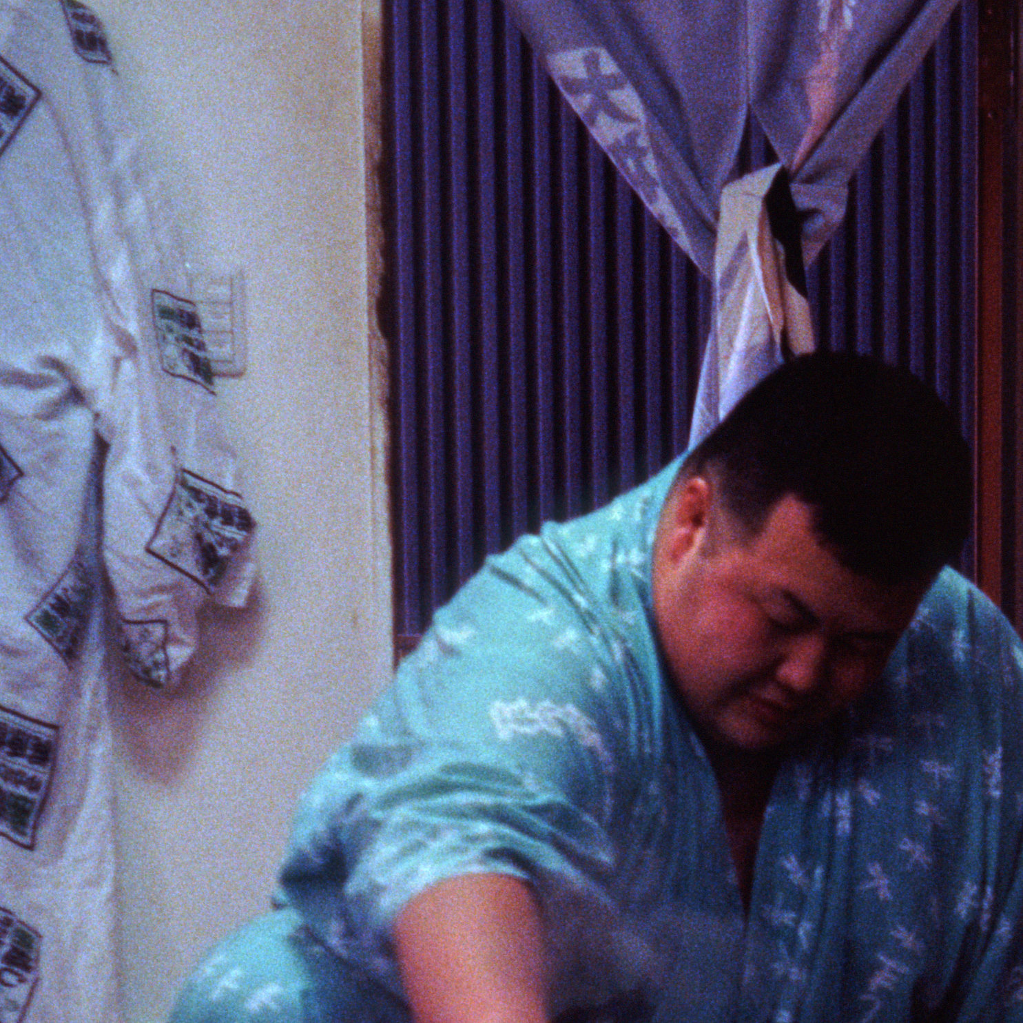

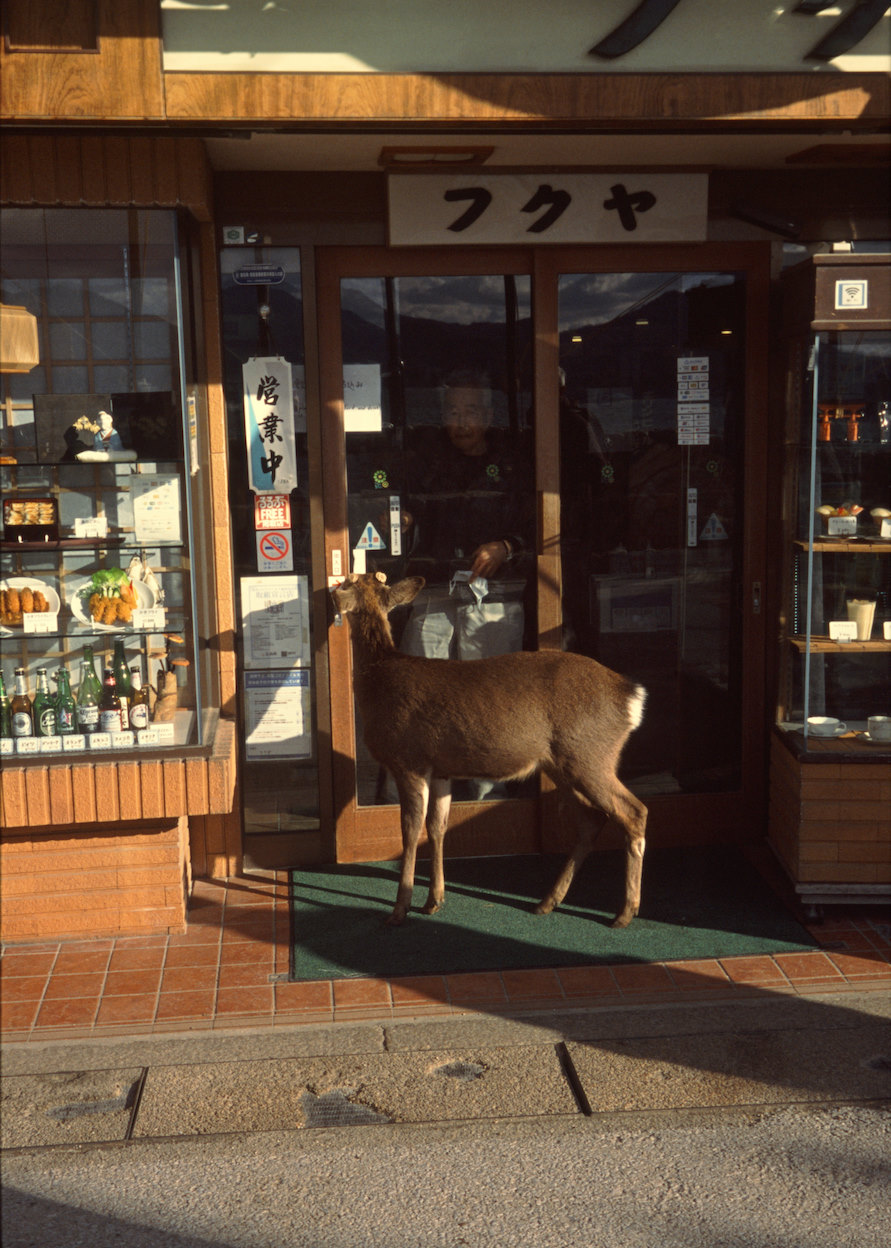

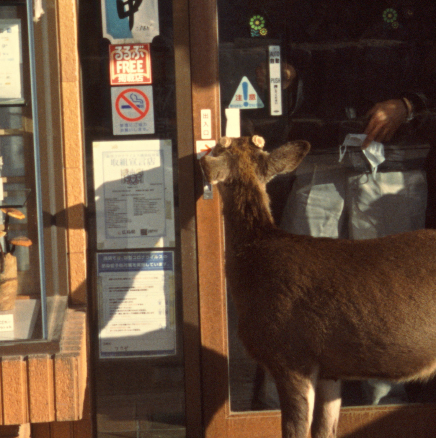

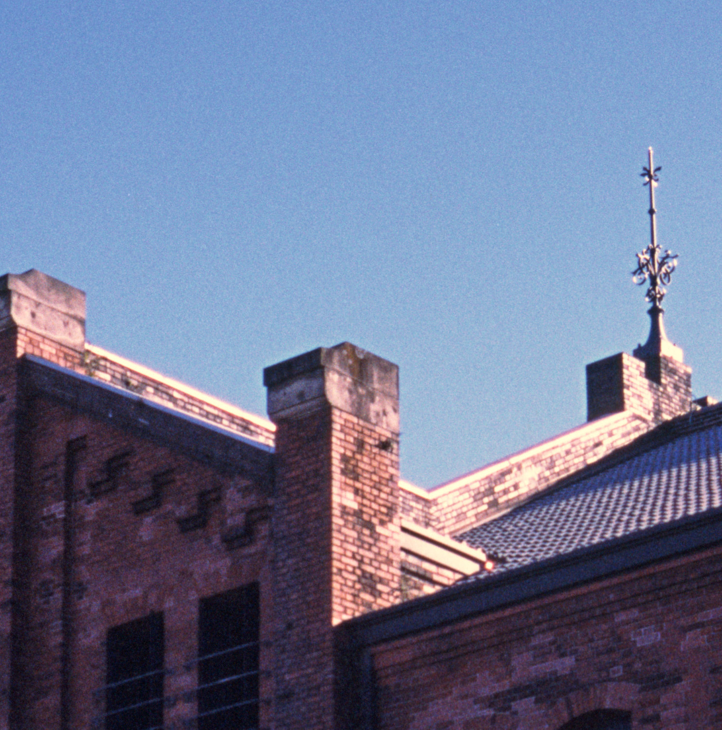

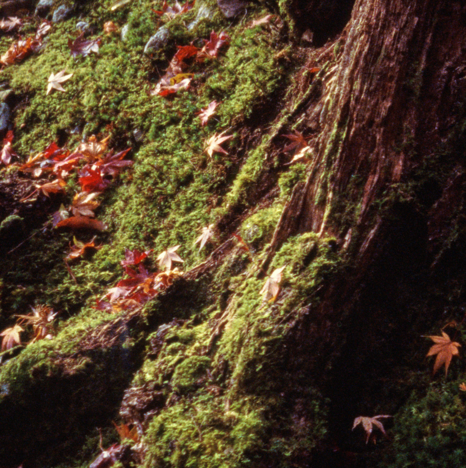

If I may bump and give some reference, I've done a lot of scanning half-frame slides with a Minolta DiMage Scan Elite 5400, including Fuji slide films. I'm actually quite impressed by what I get out of my Canon Demi EE17. And shooting nice film with half-frame feels like spoiling yourself haha!
Even more taxing, all the slide film I've shot with it so far, besides 1 roll of Velvia 50, has been pushed to make it usable in darker situations.
Here's Fuji Provia 100, pushed 1 stop:
I also cropped a 7mmx7mm area, like yours:
Here are a few other pairs, I'll keep them thumbnail size to not make my post gigantic. Provia 100 (+1):
E100 pushed 2 stops:
E100 pushed 3 stops:
So, even in color the results you can get are great. Even color slide film pushed as far as you did that Delta 400. Most of my images span f/2 to f/8, but I never let it go higher and I used f/2 and f/8 infrequently compared to apertures in-between.
I've messaged someone who's scans I admire to ask how he did them and he said he uses an A7rV with a 70mm Sigma macro, 35mm mounted on glass (dry), and he does Minox submini film wet-mounted on glass. Does your film-holder have glass?
In my case using a dedicated scanner, the issues with my film holder are mitigated by needing the film to be flat over a smaller area when using half-frame. Sometimes, one half-frame image in a pair would be OoF and the other won't, so I just rescan that odd-one out.
There are some sharper details I can see though a loupe or microscope too, but this resolution gets 95% of everything.
