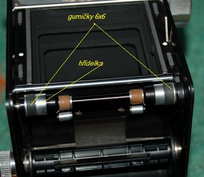

I see no way on the cameras for it to figure out when a 35mm frame would be expected to be "next" when it is so much smaller than a 120 neg, which is the camera's primary film usage.
1313_20091012155125.jpg ,
In the picture you can see a series of rollers: one external, of black color, which spin when used 120mm film, by activating gears for that film size.
The inner rolls (brown) are driving the corresponding gears to 35mm film format.
Regards.
PS: Sorry for the translation.

View attachment 83711 ,
Regards.
