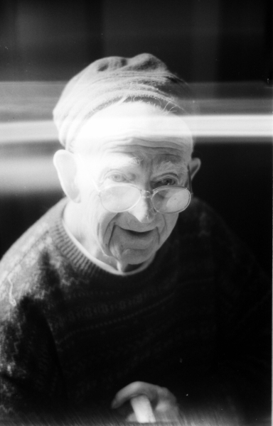

Airport scanners don't scare me. The real damage is done in the mail when the trays of mail pass through the irradiation devices. In the first year or two after 9-11, they hadn't quite gotten the hang of what dosage to use and any higher speed film passed through them were damaged. The glassine windows of windowed envelopes were frequently melted or burned.
I also had trouble with the Paris CDG inspectors. They wouldn't hand inspect and were very anxious I shouldn't take their picture, later, covering their nametags with their hand.
Below is a frame from a stowed baggage X-ray in Wellington, New Zealand. This is APX100 and unfortunately the last I saw of my father before he died 3 months later.
Always take your film in the hand baggage.
