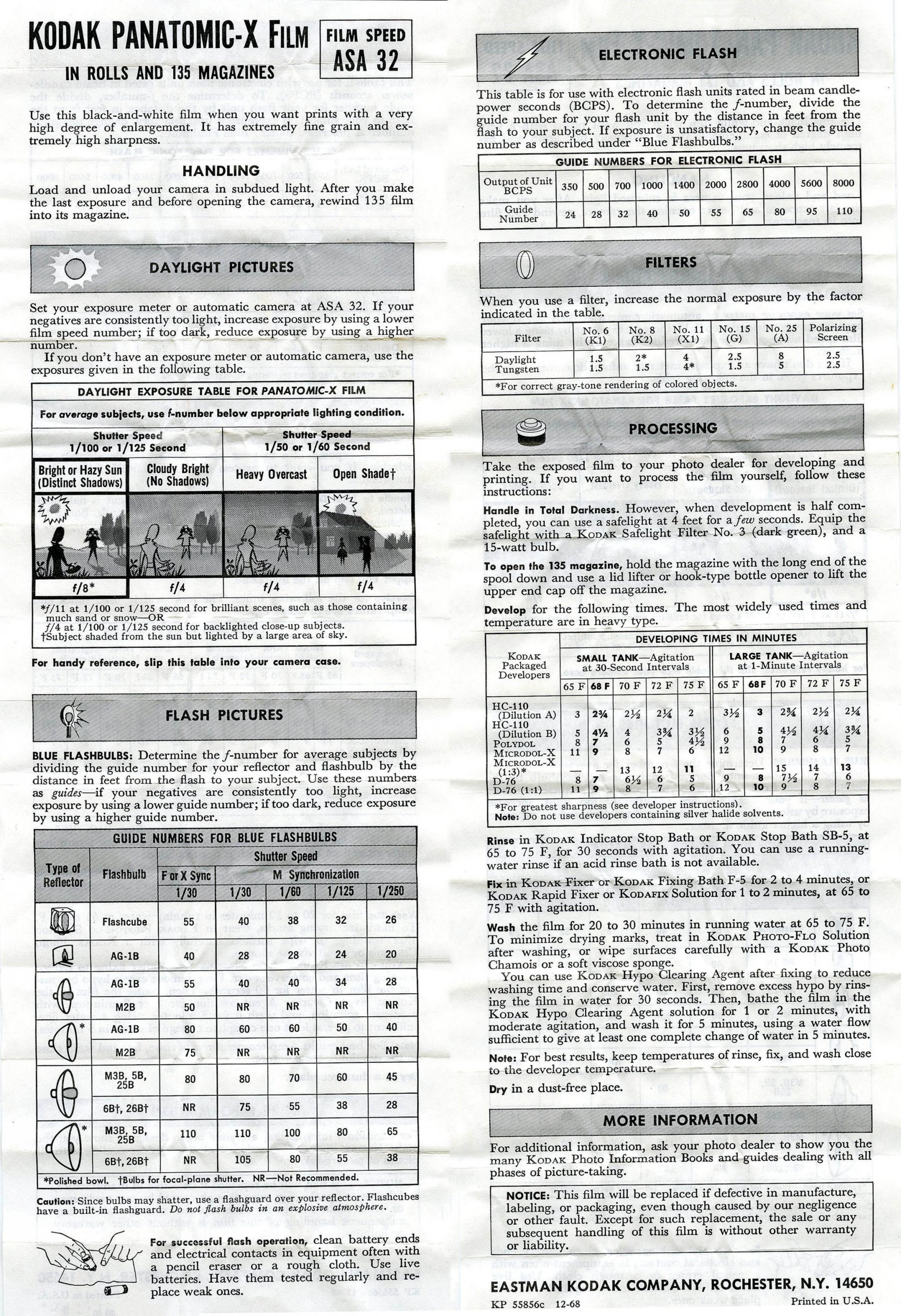

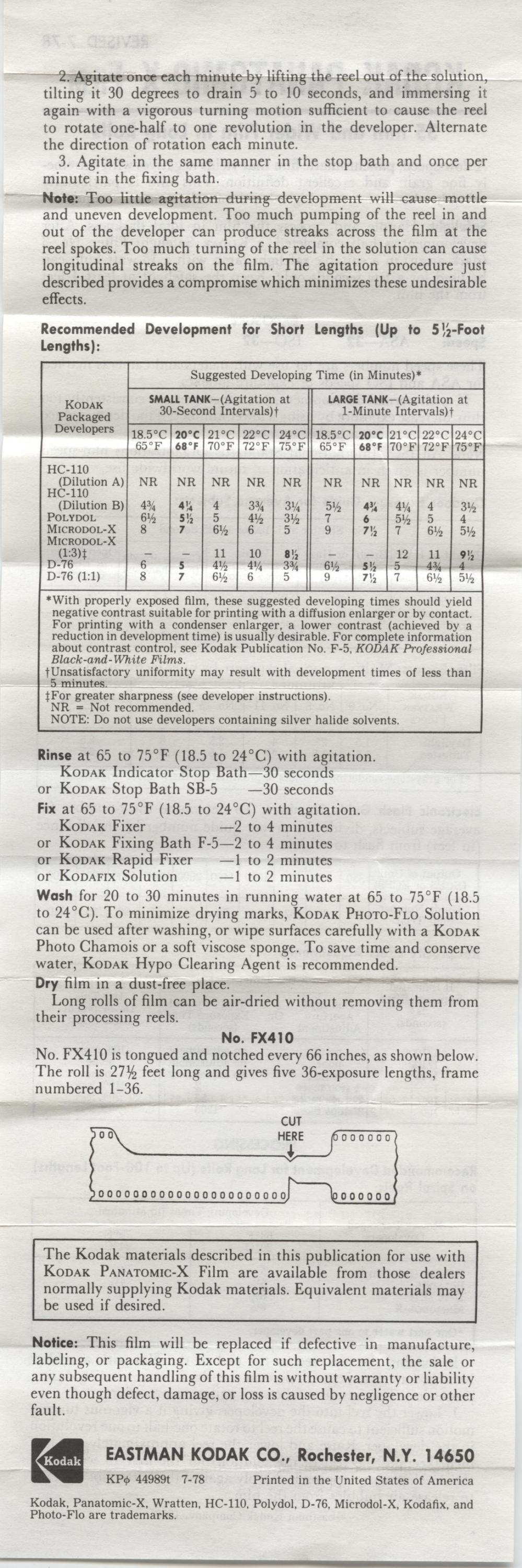

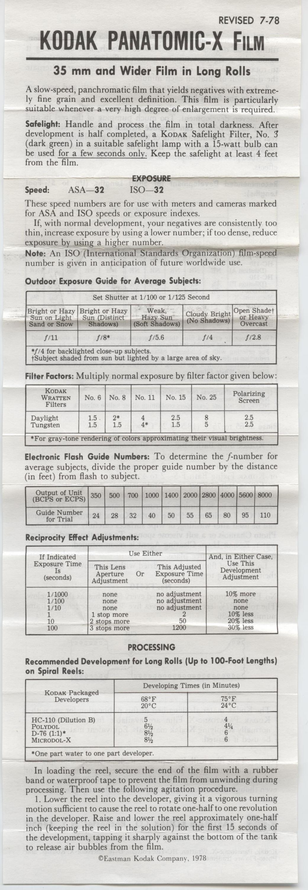

You must have gotten the film? I found one online that is a scan of the in box sheet:
http://www.tmax100.com/photo/pdf/panatomix_x_leaflet.pdf
Thanks for that link! I was gifted a 100 foot roll last fall and have had decent results using info from my mid-sixties darkroom guide, but it is nice to see (and wax nostalgic over!) the info that used to come in the consumer boxes. :tongue: I shot some on Argus Day in Argust - uh - August. 27 year old film in a 57 year old camera.
Cheers,
I was more interested in the data for the film than developing times given, characteristic curves and all that other data Kodak publishes, the technical specifications, if they did publish for Panatomic-X.

I opened up a 100ft bulk roll and this was included within.
