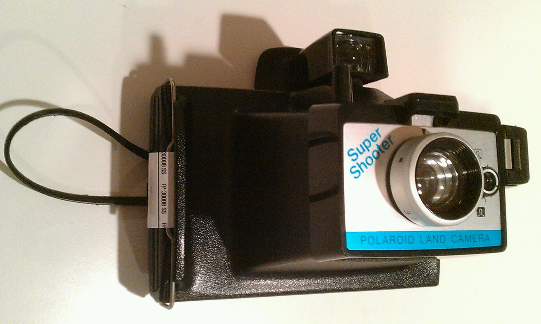

100-series Polaroid cameras can probably be found for a few dollars. My Polaroid Super Shooter produces stunning photos - it was $20, but it'd been checked out, refurbished, and sold to me at a retail store.
