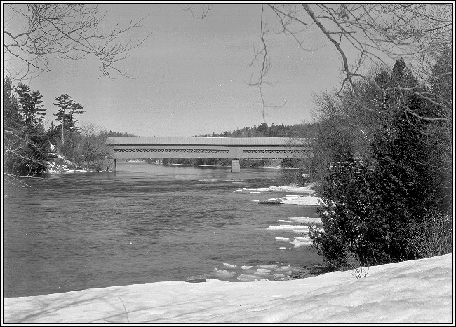

I've only had one negative fall out of a holder and that was because I didn't cut it square and so it was only supported on two sides. This Film is tough, tough, tough!! Don't worry too much about scratching it. I've tried and I've not been able to. Also, and this is just "stuff" I've picked up from web research : the aerial ISO is 200 which is supposed to translate to a normal film ISO of 100, but I shoot mine at 25 which (for me) is just right for contact prints on AZO. I develop with D-D23 and at ISO=25, I use 5 minutes in "A" and 4 minutes in "B". Being a complete amateur and not a scholar, and with a zero tolerance for the mind numbingness of math and science (and with appropriately Canadian apologies to those who enjoy math and science), I can't give you any specs, numbers, test results etc. All I can say is that it works. The attached photo is a negative scan (and I suck at scanning) and was taken with a 16.5" Goerz barrel lens using a "yeah, that'll do it" method of timing the exposure while I stood in the snow beside a muddy road with dogs for an audience ..
