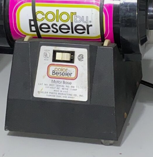

What version of Paterson tanks do you have. The Super System IV ones they have been selling for the last 1/3 of a century are slightly bigger than the AP tank showing in at least one of those illustrations.
My Beseler agitator is the same as the one in this borrowed internet image works fine with my Super System IV tanks, as long as I add a couple of thick rubber bands placed to keep the tanks from wandering off.

Thanks! I just assumed the Pattersons were thinner (not having a Jobo), because to use the new Filomat Light, designed for Jobo, with Patterson tanks, you need an adapter that looks like it adds greater thickness to the rollers.
