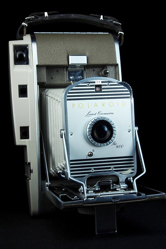

Any Polaroid camera that took type 40 film will hold a sheet of 4x5 film. You waste a little bit of the film but you also get the nice round corners. These cameras are abundant and cheap, I got this one for $20.
Polaroid Land Camera - The 800 by Bryan Chernick, on Flickr

No modification, just put the film in it. I take a changing bag and an empty film box to put the exposed film in if I want to do more than one shot.
How close can you get? Any good for portraits?
