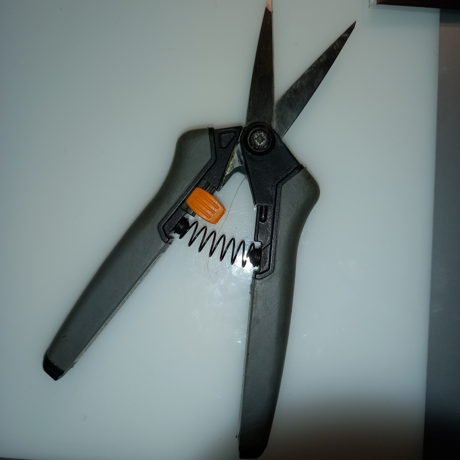

No special tools needed, certainly not a film cutter, though that's what I used when 35mm was more widely shot than it is now. A steady hand and precision Fiskars shears, straight down the rebate that delineates individual frames. Pre-cut archival polypropylene card mounts (35mm, 6x6, 6x7, 6x9) have been my go-to mounts preparatory for scheduling scanning and printing. These are made Clear>File / Black Mask Transparency Sleeves. Individual frames are secured over the pre-cut opening with ScotchStrips, secured to the rebate of each frame. Each mask is then labelled with scan and print-step references for the lab.
You may want to experiment with using any sort of scissors, but they must be sharp and provide a clear, unobstructed view between frames.

If you decide to use scissors, practice cutting some leader. It can be easy to cut at a slight angle. This would, of course, be hidden by the slide mount, but may annoy you anyway.
