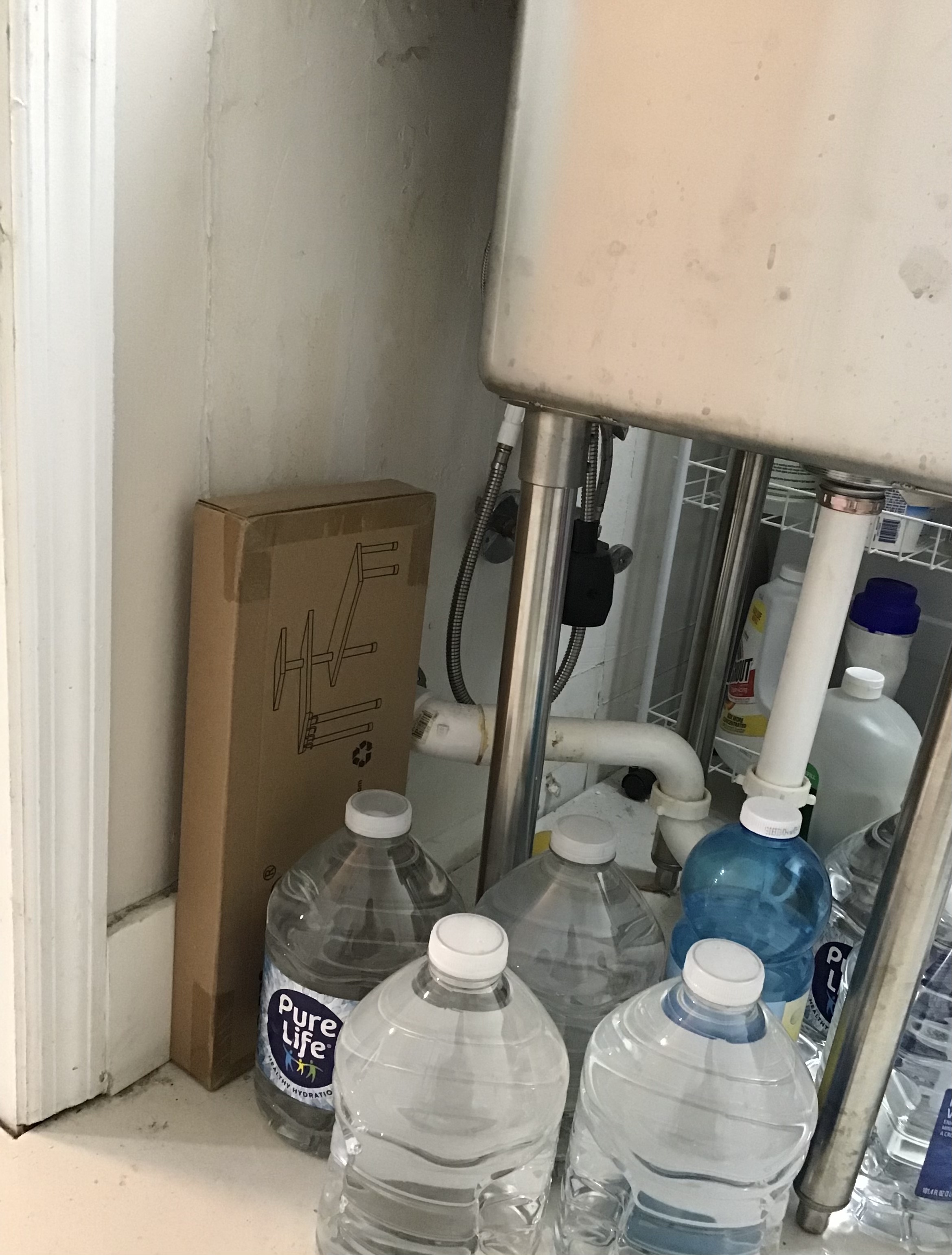

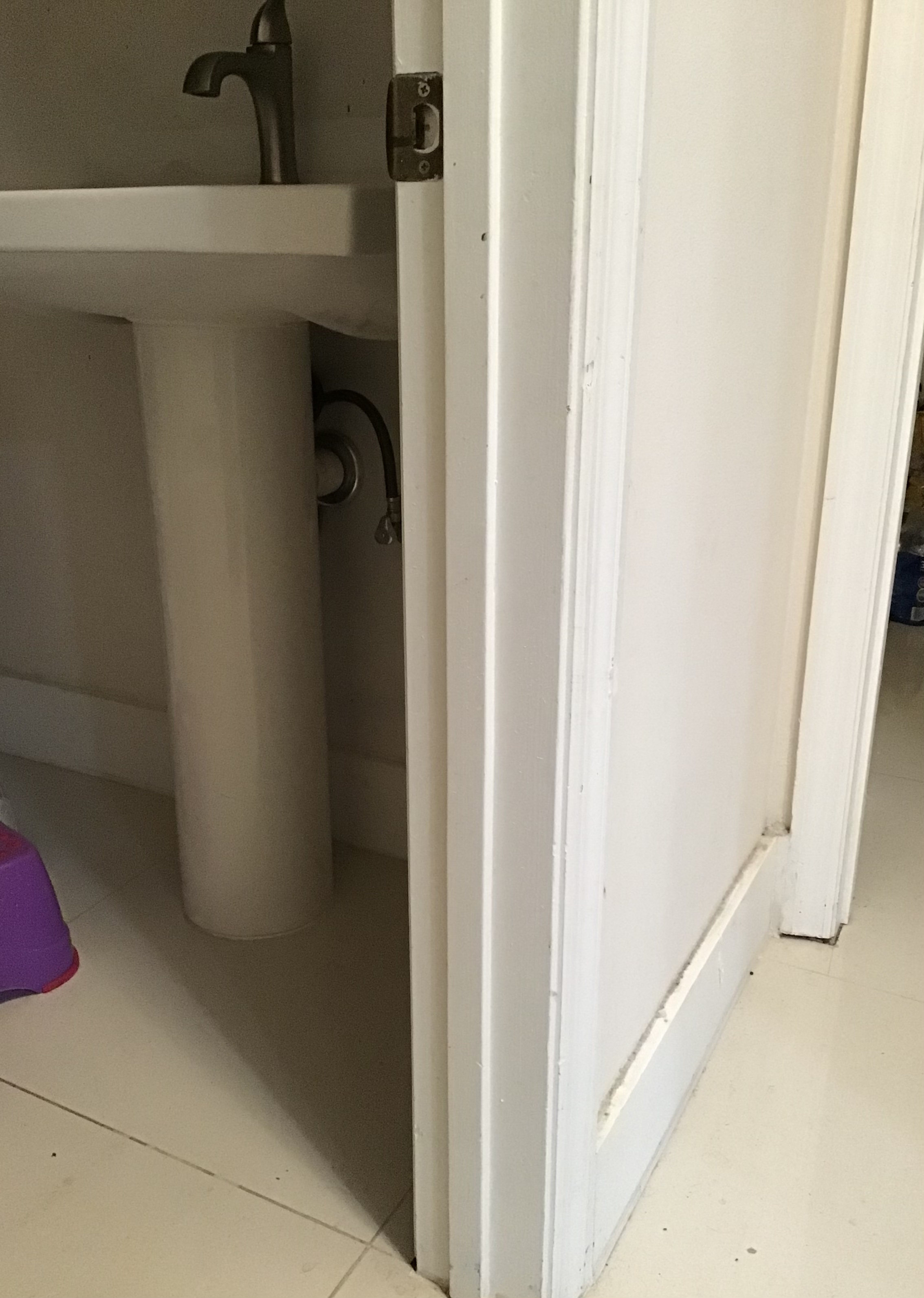

Gentleman (I presume), thank you for the detail re plumbing Vents. I think I only have plain tube underneath (incl the rear of the standup sink). Have a wonderful Turkish plumber here who’s the go-to guy and will reach out if massive flood dumping doesn’t clear the smell. For visual, am dealing with these two which share the common wall in between (they’re essentially back-to-back).
MattKing
Apr 24, 2005
55,141
Delta, BC Canada
Venting is usually/often only visible if you open the walls.
