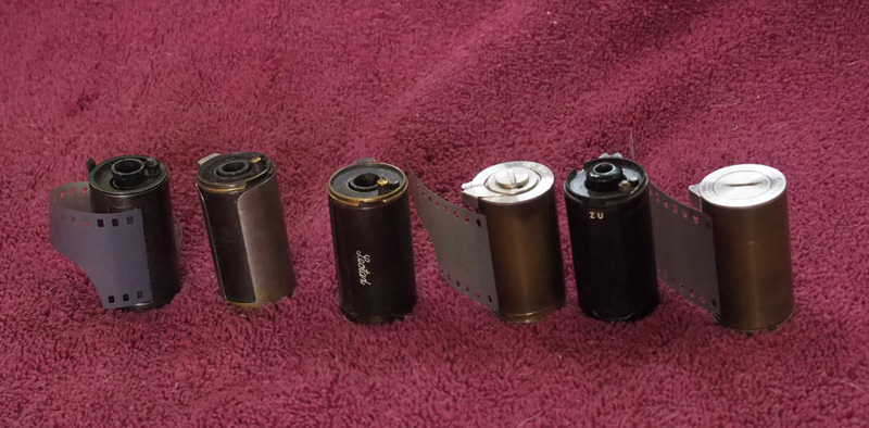

They have a Z or N on top, depends which way you look at it. There are two Leica cassettes, the FlLCA has a black or brass knob on top and the IXMOO has a chrome knob. The IXMOO is a little shorter than the FILCA. The IXMOO works in a M mount Leica and the FILCA works in a Barnack Leica. The one on the far left in the photo above is the FILCA. The second from the right looks like a Contax cassette.
The order in the picture from left to right Leica FILCA, early Canon (the VT/L1 and later use a different version with 1 knob called a Model V), Leotax, one version of a Shirley Wellard, Contax and then a different version of the Shirley Wellard universal. A Zorki/Zenit has its own, it looks like a contax but is clocked different.
