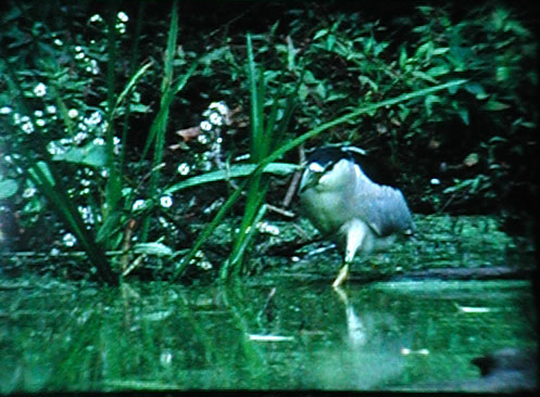

By the way, for those who are curious about E-6 stocks for Super-8, here are a couple of frame grabs. The first is Ektachrome E-100D, cut down and respooled for Super-8, available in the U.S. from John Schwind (who generally has good prices on Super-8 film). The second is Velvia 50D, cut down and respooled for Super-8 from Spectra Film and Video. I should have used a warming filter for the Velvia in the shadows there, but the film is very saturated and fine grained. I'm not a Velvia fan in larger formats, but for Super-8 for projection it's excellent.
