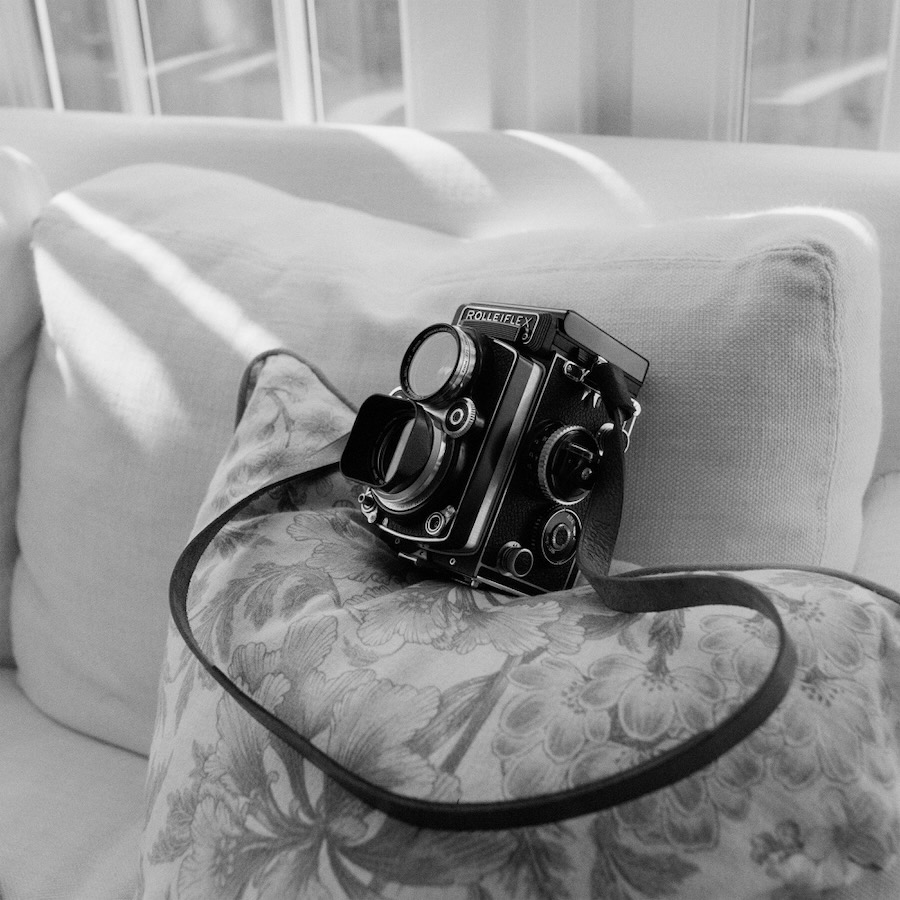

Did you expose it at EI 3200? One common advice about Delta 3200 I see spreading online is to expose it at 800 or 1600. Doing so will lead to crap results. It's quite apparent that Ilford wants you to expose at 3200 and accept somewhat crushed shadows.
Delta 3200 exposed @EI 3200 with incident metering, developed in Xtol:

@Radost if you're still curious about this film and willing to experiment, try exposing at 3200. You're compressing mids/highlights by exposing at 1250. But you have to pick a developer that works. Xtol is actually quite tricky - I was only getting good results with stock full strength Xtol. Not 1+1 and not replenished.
Delta 3200 is a tricky film to use, I can see why some folks prefer pushing HP5+. But it's worth the effort. Nothing else is comparable in medium format.
