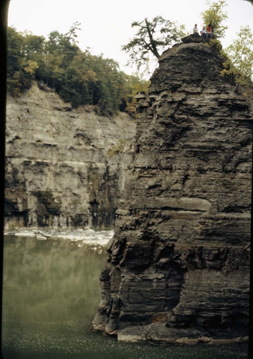

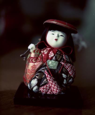

There are some examples here and there, but here are some of mine.
I have a 16x20 of the rock in pond photo in our living room.

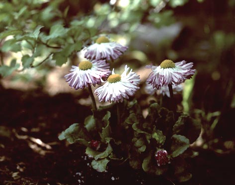

Sorry, the flowers photo was cross processed Ektachrome in C41 with normal RA4 printing. But that too is possible as you can see.

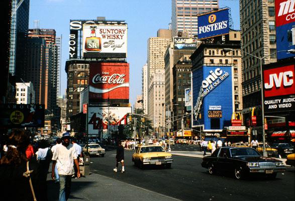

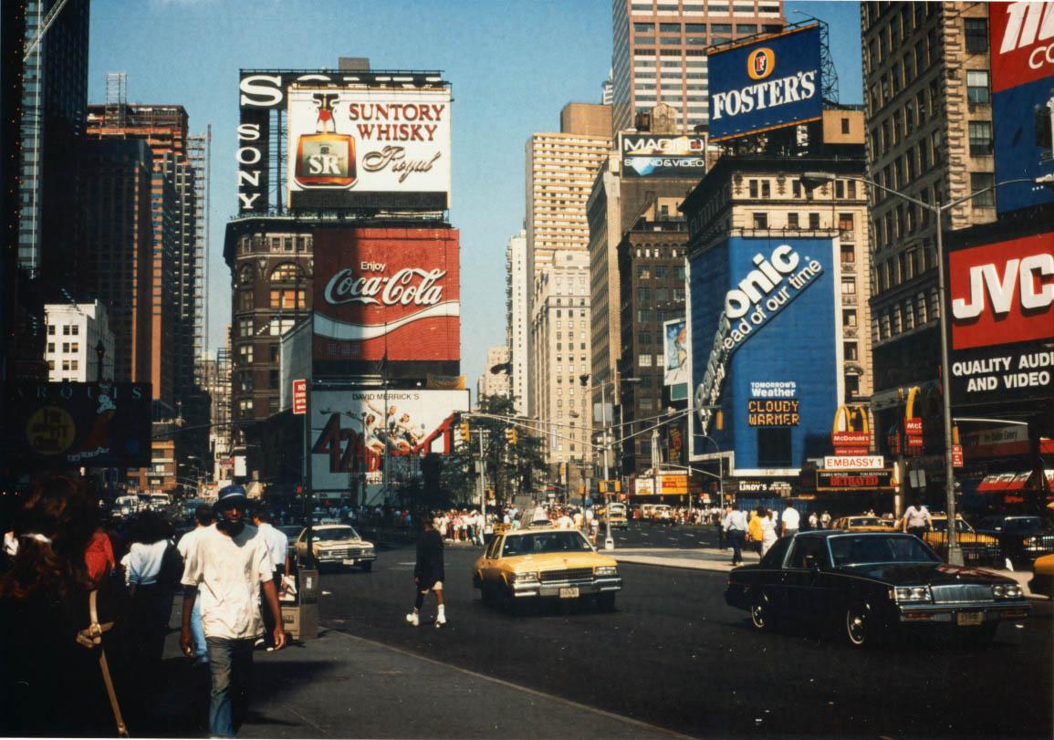

I did RA-4 reversal process some years ago. It works but it is not easy.
The main problem is the very high contrast of the result.
I solved this by pre-flashing the paper, but controlling all variables is a pain.
This example was on Fuji CA. As first develper, I used Tetenal Centrabrom.
The first is the scan of the original slide, second is the normal reversed RA-print and third is the preflashed version of the print.
Another way with good results I used later, was using ECN2 motion picture film as internegative film.
Joachim

Yes, of course!
Tower rock is from Ektachrome Professional (EPP) onto Portra 160, Birds of a Feather is Kodachrome 64 on to Portra 160 and Merry Christmas is old E4 Ektachrome on to real internegative film.
The real interneg was shot by my uncle (also a photographer) and printed onto interneg film by EK.
PE
