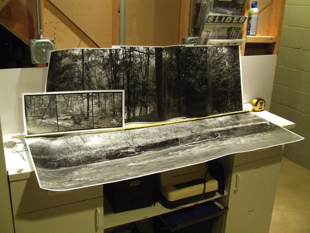

It might be easier to affix the individual processed and dried prints together since you can see the resulting image. Of course there will be a line. The bottom print shown here is on four pieces of 16x20 paper.
If you can figure out how to expose the individual parts on a single piece of un-processed paper that would be quite a feat!

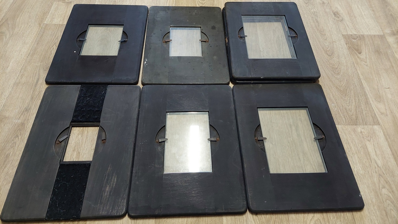

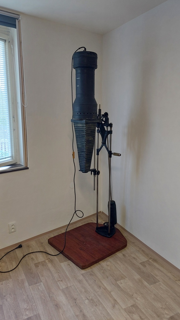

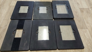

I have a prehistoric enlarger where wooden masks are inserted between the lamp part and the bellows and nothing limits it from sides. The mask for 6x9cm (bottom left) I have cut for 6x17 pano. So I could, for example, modify the existing mask for 10x15cm film (Europe) and expose the negative 30x10 through it in two steps.
But I have no idea how to hit the transition more or less precisely.
