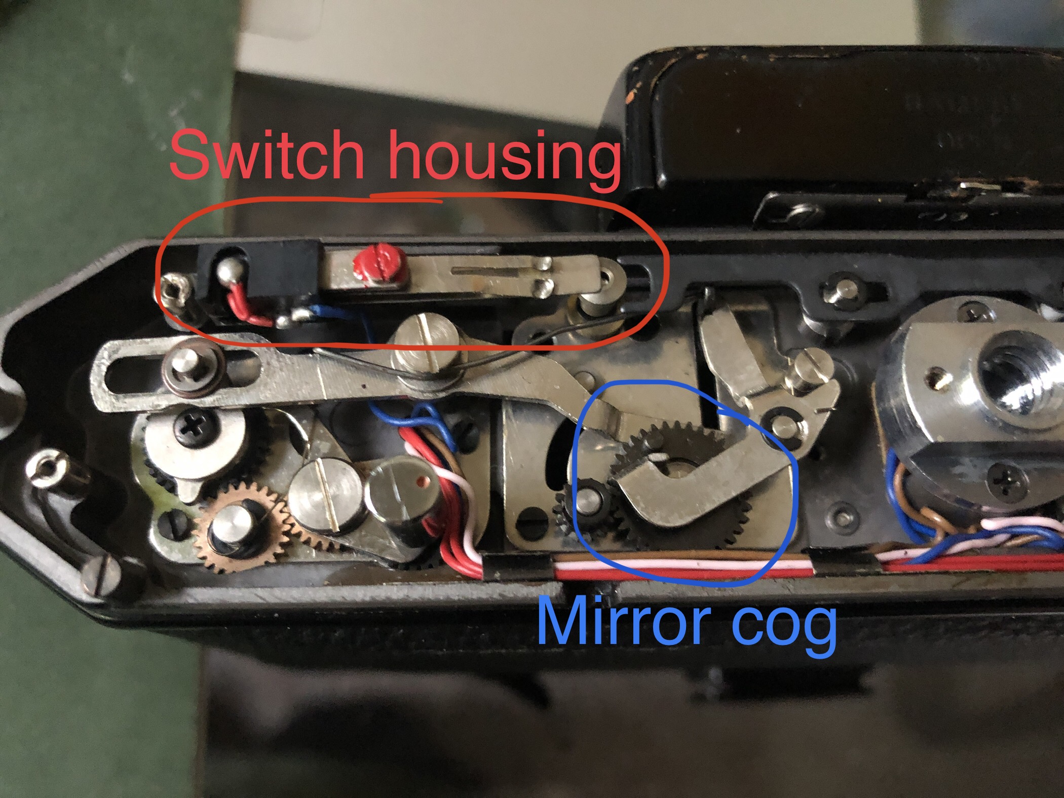

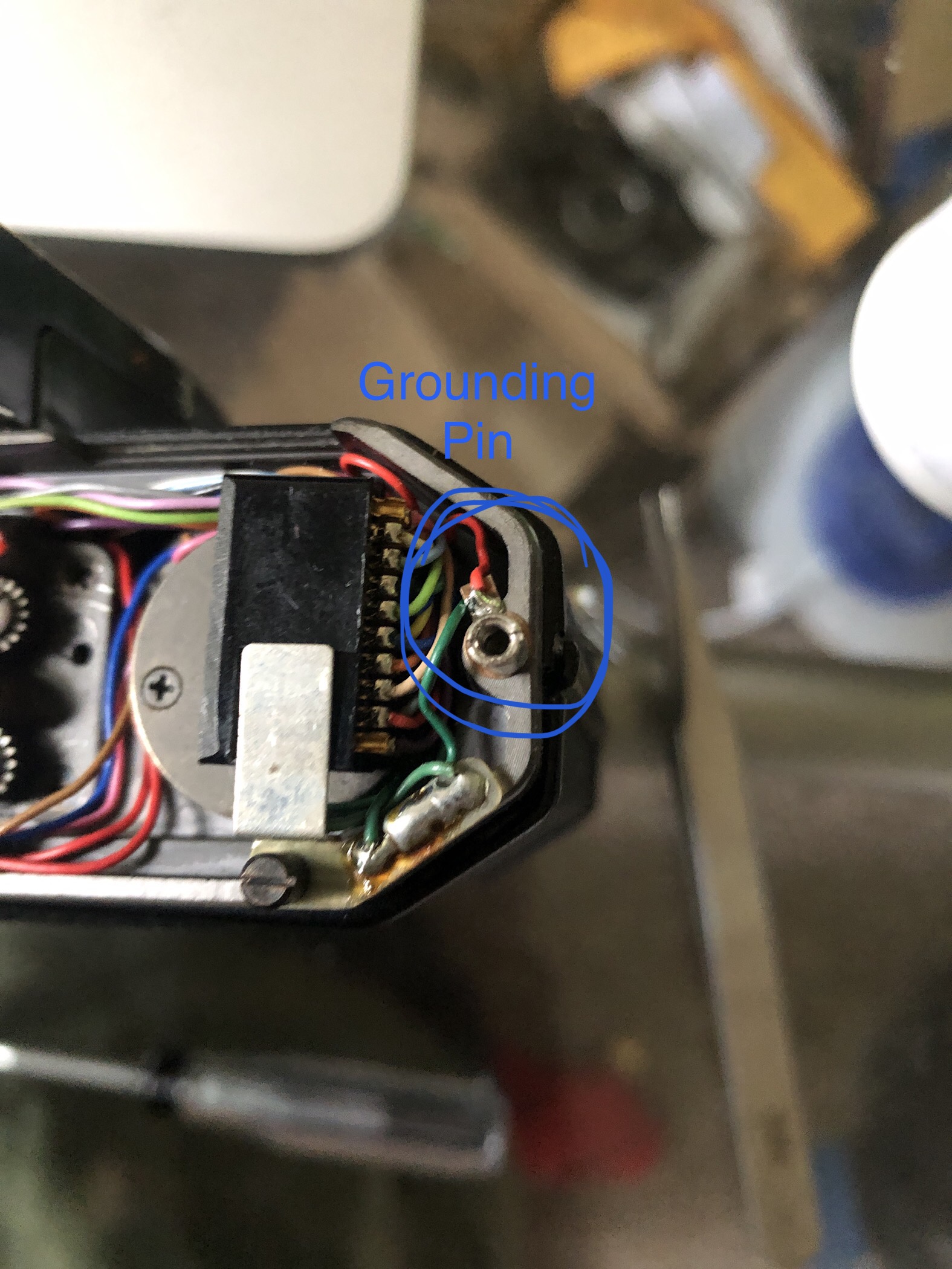

How do you do the cleaning? Do you mean cleaning the battery contacts or disassembling the body? Thanks!
Cleaning the battery contacts if they’re corroded (you’ll know if the battery test button fails), if they’re clean and the electronics are not working pop off the bottom plate and check the two posts which screw into the frame- the one closest to the circuit board connector is a grounding post and can come loose or get funky.
The other issue is mechanical, sometimes the mirror return cog gets gummy from dust and oil mixing and the mirror locks up, especially on auto and slower speeds. With the bottom cover off, remove the three screws holding the motherboard on and gently pull it out of the connector (it might need to be wiggled but should come out easily). There is a mechanism by which an arm cocks the mirror return by raising a lever, and the black cog releases it when you hit the shutter button. A drop of a thin lubricant, sewing machine oil or the like, will free this and return the mirror consistently. Just fire the shutter a few dozen times to work the oil in. This works on all spotmatic series cameras to my knowledge.
Oh- another issue is the switch that pushing down the shutter button turns on, it’s those two metal ribbons above the mirror mechanism. Sometimes the black plastic switch housing (circled in red) gets cracked with age, a drop of super glue in the crack while pushing the plastic together will keep it from getting worse. The bifurcated ribbon that normally doesn’t move can be bent to make contact again while depressing the shutter release. These three issues are probably present on most of the non-working cameras and really aren’t a terrible fix. Sorry if I didn’t explain that well, I’d be happy to give a better explanation if you need it. Hope that helps!

.... With the bottom cover off, remove the three screws holding the motherboard on and gently pull it out of the connector (it might need to be wiggled but should come out easily). ...
The circuit board is connected via the black block on the right side of the photos. Before putting it in again after service clean the contacts on the board (with isopropyl alcohol) because after 45 years they have collected a patina and perhaps dust just outside the small contact area between connector and board. When you put it in again you never catch those small areas again which may result in a heightened electrical resistance.
Also be careful not to bend the board excessively when removed, because the solder joints of the components (a tin/lead alloy) may have become somewhat brittle (crystallized) which can also result in bad contacts. Failures of this type are difficult to pinpoint and occur randomly.
