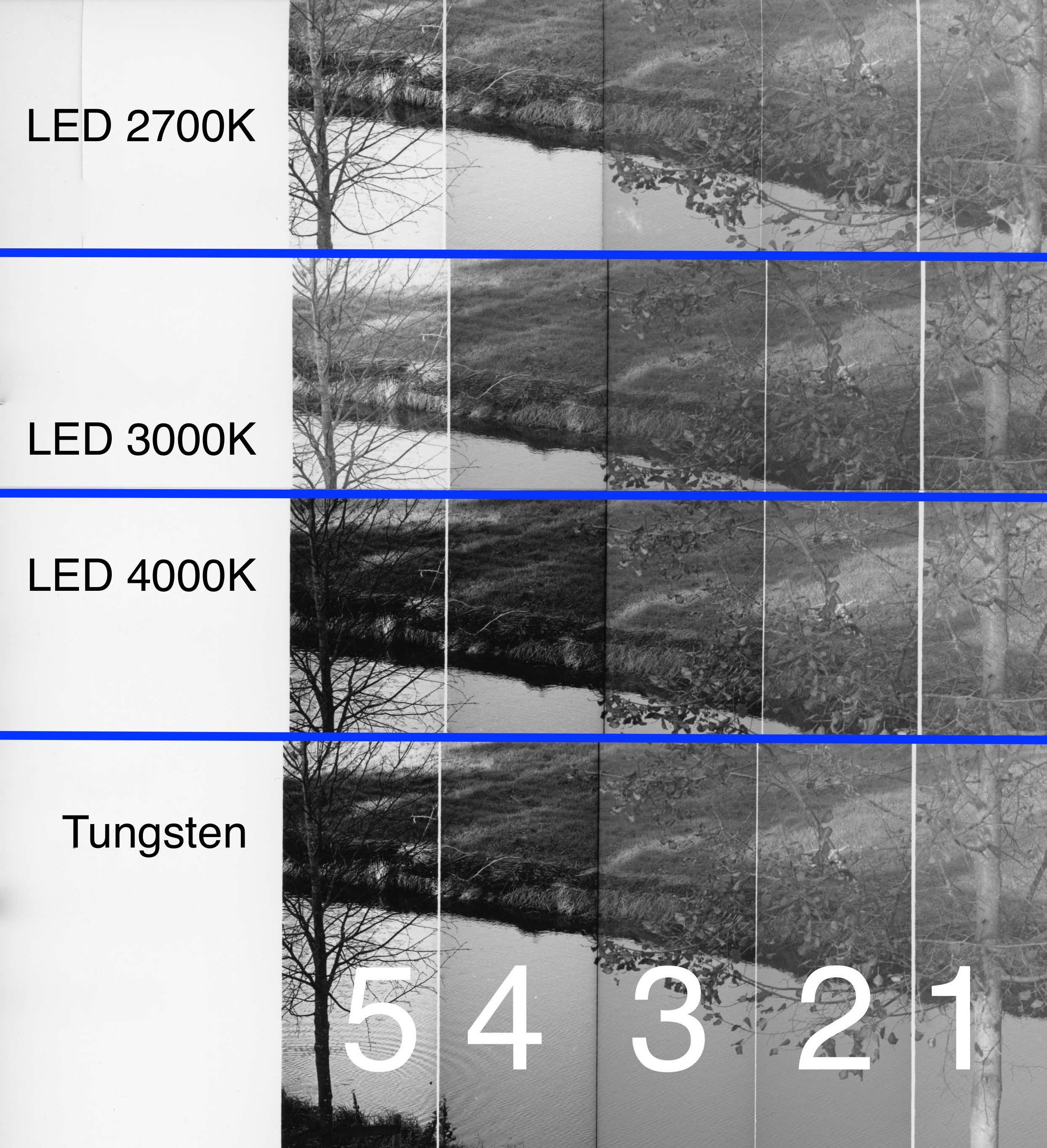

I did some tests with LED bulbs a few years ago and the found that a color temperature of at least 4000K was needed to get all contrast grades. But this was a few years ago, it may well be that nowadays LED bulbs are different.
Others have found the same, my negatives are scaled to print grade 2, not very often I print beyond 2 1/2 sometimes grade 3. I only use grade 5 when split grade printing.
