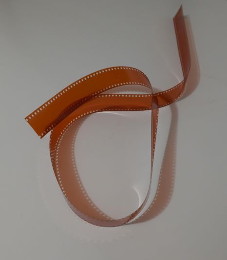

You could develop a roll of film like I did with some 4 month old Cinestill Cs41 and end up with a roll that looks like this!
A leader test would have avoided this failure, but maybe not prevented poorly developed images.
