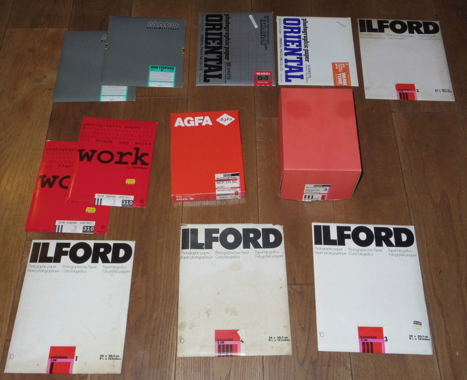

Hi all,
I just got over 300 papers (18x24 and 20x30 cm) on auction site for 16 euros :smile:. Any of those will be good for Lith print? I have Moersch Easy Lith at home, I will try it on the weekend, but just to know what to expect :smile:.
Thanks,

Oriental and second pass lith can be quite nice although sometimes a little weird.

If that paper isn't fogged, you got one heck of a deal there!

Funny you should ask . . . spent several hours yesterday bleaching and lithing old Brovira, with unimpressive results. Neither copper sulfate or KBr/Ferri responded strongly. These were grade 1 and 2 papers, which might have something to do with it.
I have lithed the Brovira in higher grades, and also the MCP in fiber form, but I don't know if either had changed to an emulsion with developer incorporated. For a quick test: Place a drop of "B" or NaOH onto a test patch, with the lights on. Devolopment indicates developer incorporated, and will not lith. Additionally, it is a legitamate question as to whether processing these papers will kill the lith effects of your lith developer. According to Rudman's book, if you want to switch from lith printing to conventional printing, simply add a little conventional developer to the lith pan. I hypothesize that adding a developer-incorporated paper to the lith pan will degrade the lith developer.
So, I would do the quick and easy test first.

First part of the test - developing in Ilford PQ universal is done:
Brovira is in good condition - no fog at all, nice and contrasty:
Oriental warm - wow what a beautiful paper, I want to buy some more! Where I can buy this in Europe?
Ilford Ilfoespeed was also OK:
Afga MPC 310 had some strange pink color - ugly, Oriental FB had too low contrast, tetenal WORK did not tested yet.
