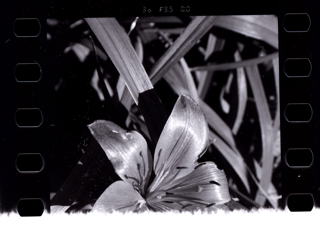

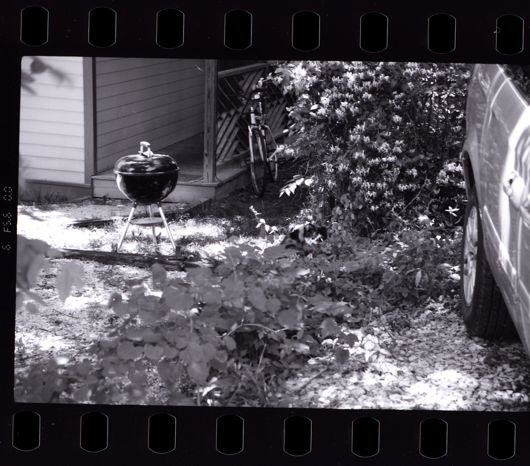

ISO 25 is a bit optimistic; rate it at 12 or so if you want to guarantee some shadow detail. I uploaded a series of 2238 exposures to the gallery a while ago, some of which I was able to remember the exposure settings I used.
No Show
Borgus Australopithecus
Hydrant Omega (cropped)
Feral Cereal
Most were exposed between f11-f16 and 1/15-1/30s in bright full summer sun; all with a Y12 filter and developed in Pyrocat-MC for 14 minutes with generous, but not continuous, agitation.
I've also reversal processed a roll (clear base!) but it needs to be rated closer to 6 or 3 ISO for good positives. I've got a short roll on hand (and a bunch in the fridge) plus the chemical stock to mix up some DK50 if you'd like to pitch me a development time @ 25 ISO.
Edit: Here's the 2238 data sheet for reference. Also, all of Kodak's low ISO color process film (2254, 2383, ?) are ridiculously high resolution and fine-grained. Here's a frame of 16mm 3383 in E6 first developer.

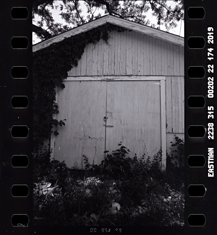

Dec 29, 2018
982
USA
Traditional
Nikon F80 w/ 24-85mm G VR, center weighted metering
2238 @ ISO 25 in DK-50 7'30" 68F, two tank inversions per minute
Exposure details in the margins
Very thin to the eye but it scans well if you can eliminate the dust.
