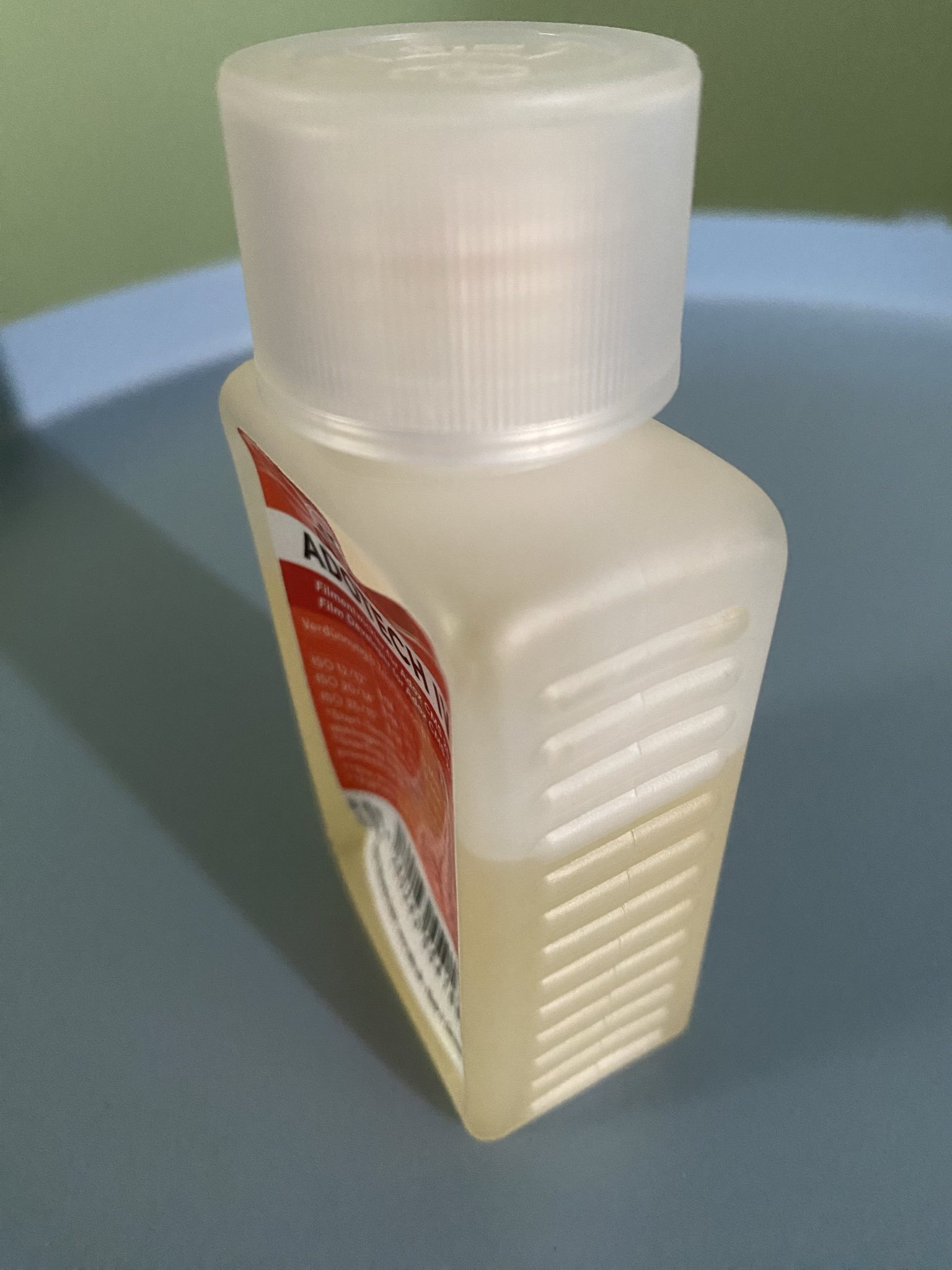

It's now 5 months since I used half the 100ml Adotech bottle. This is what it looks like now:
I can't remember if it was less dark when it was full. There are no crystals. But I am going to shoot more CMS 20 II today and try developing it again with this stuff. Hopefully it is still good. I'll try ISO 6 on a tripod with mirror lock up and use the reciprocity data provided by kind forum members in the thread here: https://www.photrio.com/forum/threads/reciprocity-for-adox-cms-20-ii.184938/
It's successfully developed the film and the negatives look about the same as with the fresh stuff. There were a very tiny amount of crystals in the bottle, total was the size of less than a grain of rice, which wouldn't mix back in. It did not seem to harm anything.
Well, that will probably be my last develop of this discontinued film. Glad the developer held out.
