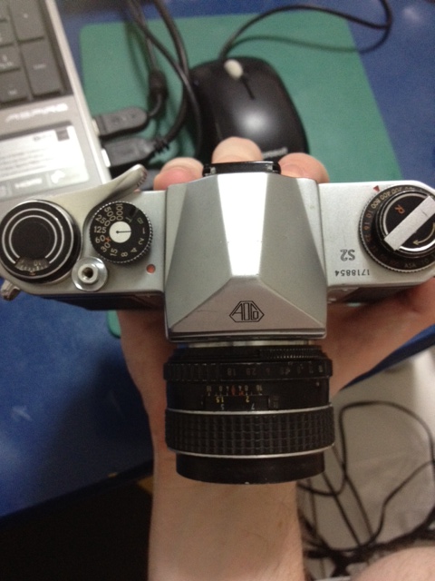

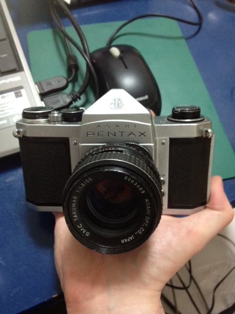

Thanks for the reply!
I'm not sure mine is such an early version though!
Here's a few quick snaps of it

Here's another photo just for kicks. Pumalite I'd be interested to hear any stories you have with/about your Asahi Pentax!
