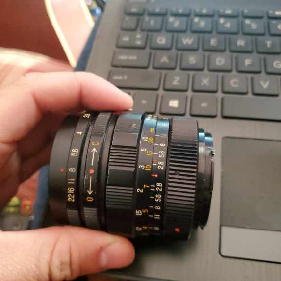

So I'm new here. I'm trying to get some information about a Japanese T-mount 35mm f/2.8 lens branded as Soligor. Now, I know Soligor is a brand name used at least partially for a lot of different manufacturer's low-end lenses, so I'm including pictures.
This lens actually looks very usable and interesting, unlike some of the Soligors I've dealt with. Actually, I'm pretty fascinated to see what the images look like. It's a decently-compact black metal unit, as you can see in the photos I've uploaded, with preset aperture, not automatic. Less apparent from the picture is that there is an eight-blade aperture with grey metal blades, and a fairly decent-looking coating on the front element
It has a Minolta bayonet mount on it, and I bought it because A: I use a Minolta SR-T 200, B: I thought I had a Nikon T-Mount lying around so I could also use it with my Nikkorex F, which I don't have a wide-angle for (turns out to be a different universal mount adaptor) and C: I love preset lenses for some reason. I just do.
So has anyone seen this type of lens? Anyone shot with it? I have no images yet, and in fact I haven't shot with it because I think the T-mount ring needs to be adjusted to get this lens to be sharp at infinity. (It has set screws and a movable sleeve that receives the threads on the lens.

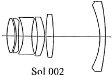

A Lens Collectors Vade Mecum states that Soligar were an independent lens brand imported into the UK in the SLR boom of the early 1960's. The name also appears as Miranda-Soligar on Miranda cameras.
was used in both M39 mount and T2 mount lens. In 1974 they had several programs running and the quality varied depending on the market they were designed for. They were Auto Miranda, Auto T4, and T2. series. You likely have a T2 series. I bought a Soligat 75-260 Zoom In T2 mount in 1972 or 1973. It was quite good. I gave it to my nephews.
The Vade has this to say about Miranda:
Yours should be a good performer.

I have loosened the screws since posting this and you are correct, the sleeve was already sitting all the way down within the collar. It's less of a V-groove, as it has a flat bottom to it, but you have the gist of it.
I don't know how to make this lens work... I suppose one would have to open the helical, no?

The T whatever to camera make was suppose to position the lens to the correct distance from the film plane for correct infinity focus.
If it does not make infinity at the film plane then the focus ring may be off or a similar mechanical error. The lens appears to be assembled correctly in your pictures.

So it does have to be taken apart to be fixed? Because I have now disassembled and reassembled the mounting ring and mounted it on the lens in what has to be the proper position.

In your 2nd photo there is a screw in the focus control ring close to the rings infinity mark, are there others?
The trim ring with the serial number / name / focal length should unscrew with equal pressure 180° or 3 points 120° apart. The front element retaining ring should be behind the trim ring and if pristine the lens has not been taken apart leaving the focus error likely to dried lubricant, tale tale marks says its been opened and possibly the mechanics not reassembled correctly.
An investigation is in order.

Well, I do see a mark on the badge ring that looks like such an operation has been done. I kinda messed up the last lens I opened, but it was built in Ukraine under Kruschev, so maybe it was not completely my fault...
I'll most likely attempt opening it tomorrow.
