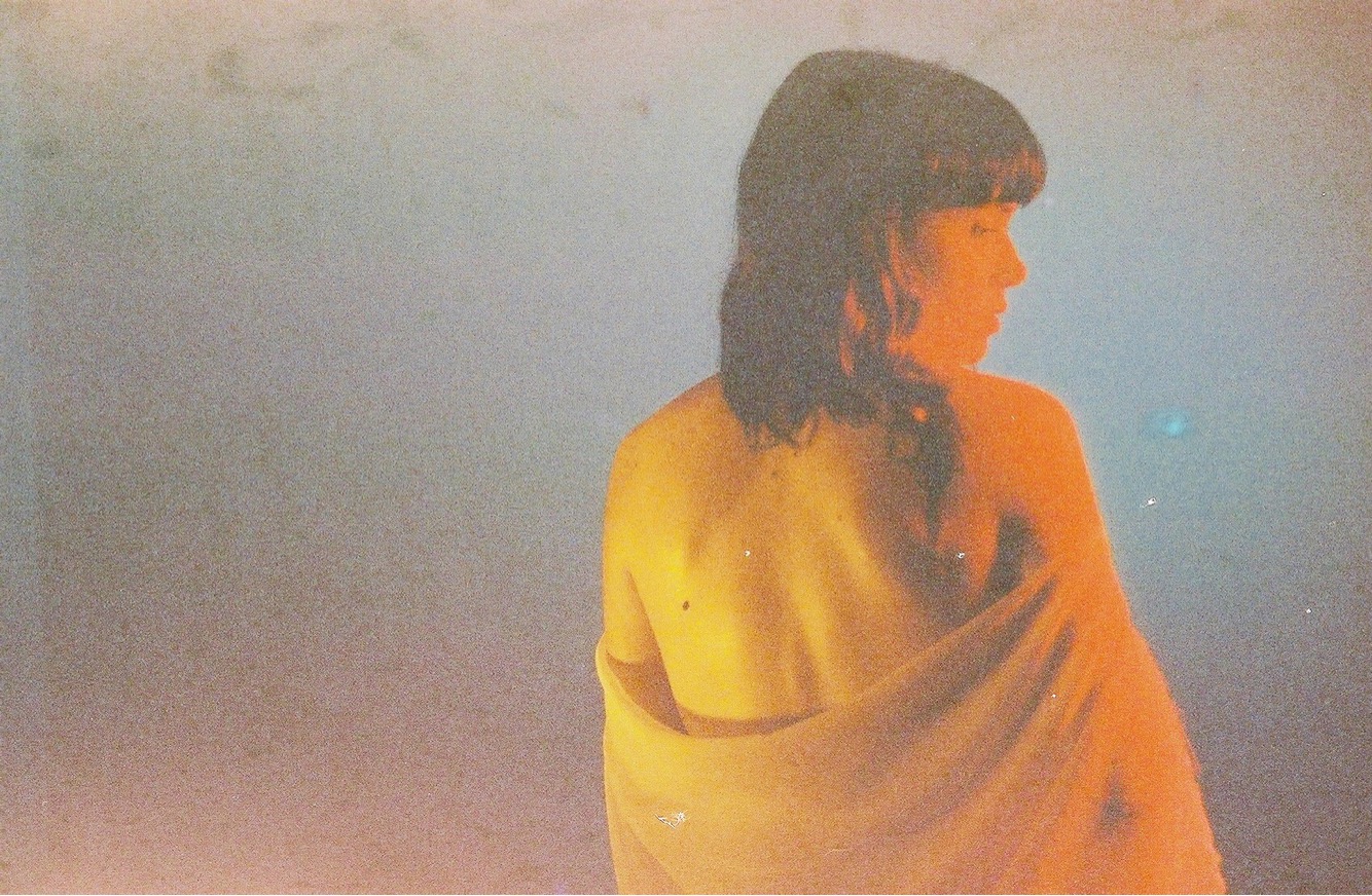

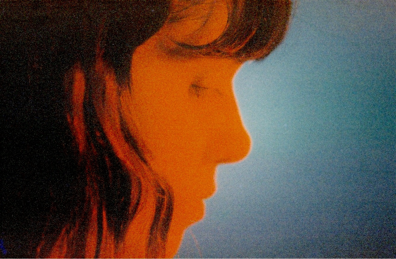

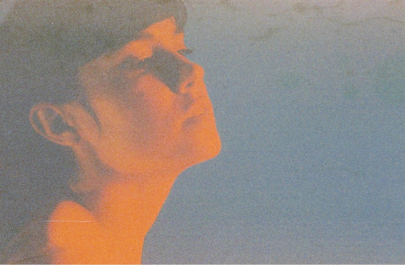

Hey guys, just shot a roll of cinefilm800 with a canon A1 which came back looking particularly rough. As you can see it's pretty grainy & dirty without a whole lot of definition, and the black point is way off. I did shoot 2 stops under to avoid the bright lights blowing out, would that explain a bit of it?
Would light leak have something to do with the lightness on the edges and maybe how washed out it looks? Are those dark blotchy patches on the edges a result of bad drying after development?

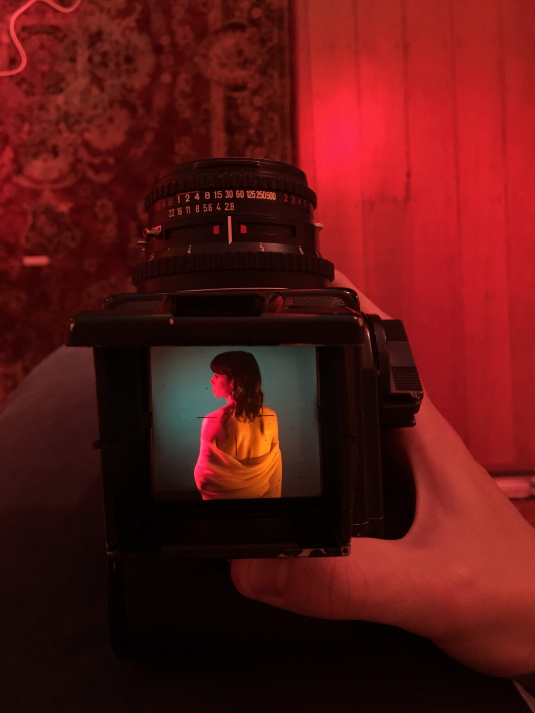

Attached is a quick reference snap of the scene through the viewfinder of my hasselblad (still haven't developed that roll). Also the film I used was tungsten balanced (hence the colour shift).

You cannot avoid blowing out lights especially when all else is dark. Since the scenes are 2 under, the autoexposure of the scan did poorly which greatly exaggerated grain.

Underexposed for sure. Common wisdom with negative films is expose for the shadows, they have plenty of latitude for highlights.
With a portrait all that matters are the skin tones. I would have a) spot metered on the model's face and opened up one stop or b) used an incident meter held under the chin.

It's Cinestill, what would you expect! When you repurpose a film for other than its intended purpose you are not going to get good results. What you are getting with this film is a tungsten balanced film sold for use in daylight. Then to further confound things it is an ECN film cross processed in C-41 chemistry. And then as a final flip of the finger it is not sold at a bargain price. I have developed quite a bit of cine color film but used the correct film (D or T) and processed it correctly in ECN chemistry. Color balance was what it should be.
If the film appears dirty then it might be that Cinestill botched the remjet removal.

That look is typical of what I have seen when there has been an underexposure that is being tried to fix digitally.

This film is actually 500 iso (it is Vision3 500T), so underexposing it two stops from 800 iso pushes it to its limits.

I know it wasn't your intended result, and I can definitely relate to the disappointment of a roll not turning out as planned but, just for the record, I happen to think the second frame (8252) looks pretty great. Intentional or not, it's a really cool look!
Thanks! That is probably my favourite from the roll as well. I am pretty happy with the creative, the artist I'm shooting for is in love with the images as well, I'm A little disappointed that it's lacking on the technical side.
