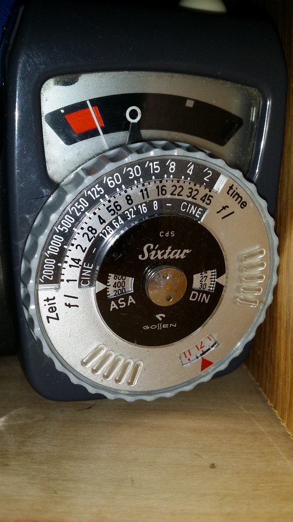

I have this one still, but, it is hard for me to understand! I DON'T KNOW ITS CURRENT VALUE, IF ANY, SO, IT IS HERE FOR NOW!
20140804_212236 by a.rodriguezpix, on Flickr
AgX
Apr 5, 2007
29,973
Germany
By turning the dial make the digit match the needle and choose one of the time/aperture pairings at the scale.
