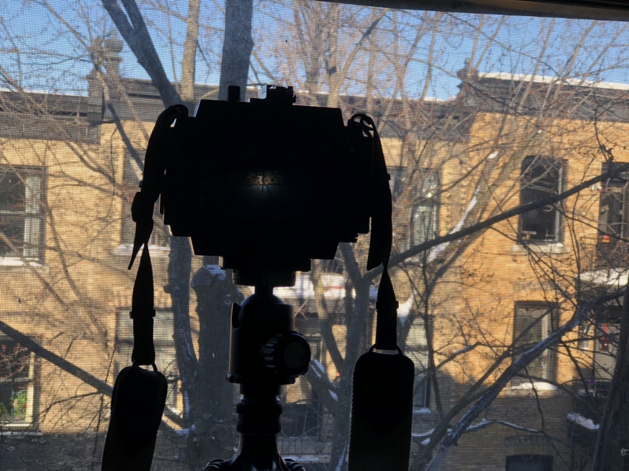

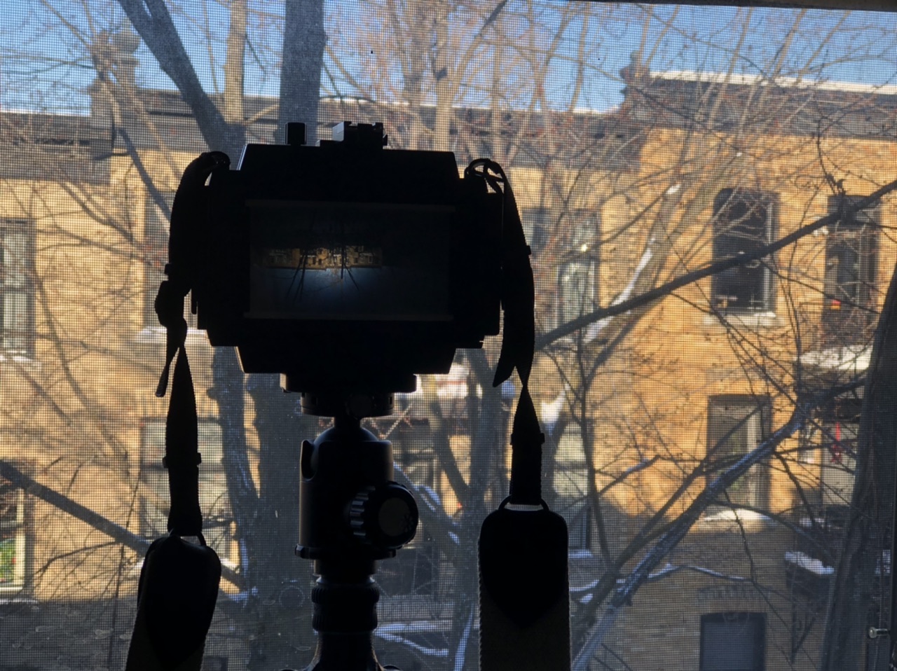

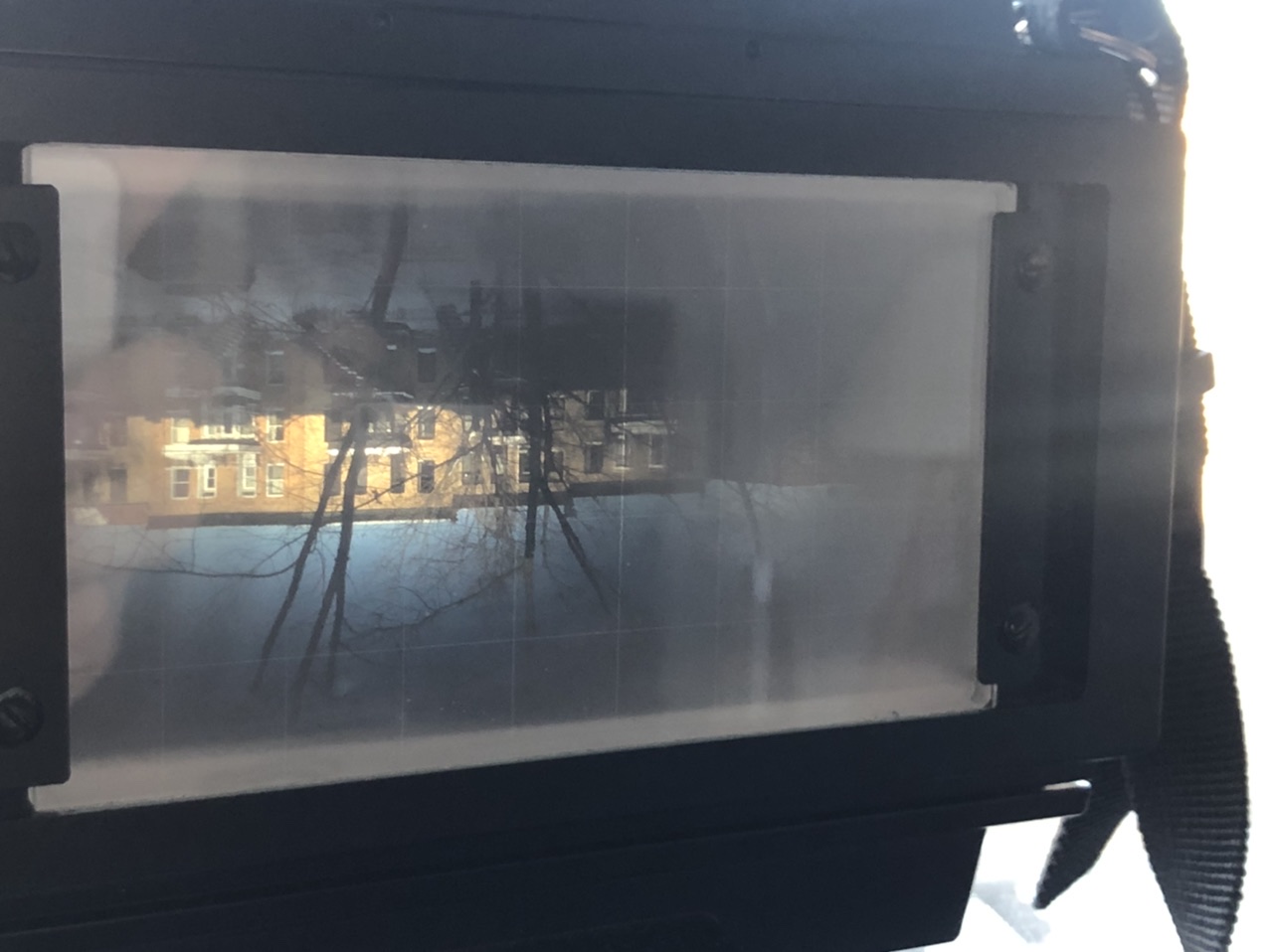

Sorry for the delay @Fragomeni here are some samples of fresnel vs no-fresnel with the 35mm APO Grandagon :
With Fresnel
Without fresnel
Close-up with fresnel:
