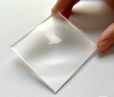

OK, a brief impression. Both the Magicflex and Chinese screens have a mottle pattern to them. Very similar, I wouldn't say that the Magicflex was different. Similar pattern, etc. A series of small black dots all over the screen. This is sort of like the frosted glass in bathroom windows? It serves as a bit of a focus aid- the mottling gets more blobby the further out of focus the area is. The screens have a nice snap. All in all the mottling and black dots are bit off-putting. Sure, a Maxwell is nicer. A Mamiya is nicer. An Oleson is nicer. You spends your money, you makes your choices.
Bad image, hard to photograph this kind of thing. And the fall-off to the edges is from the camera lens, not in real life. Pretty even illumination across the screen.
