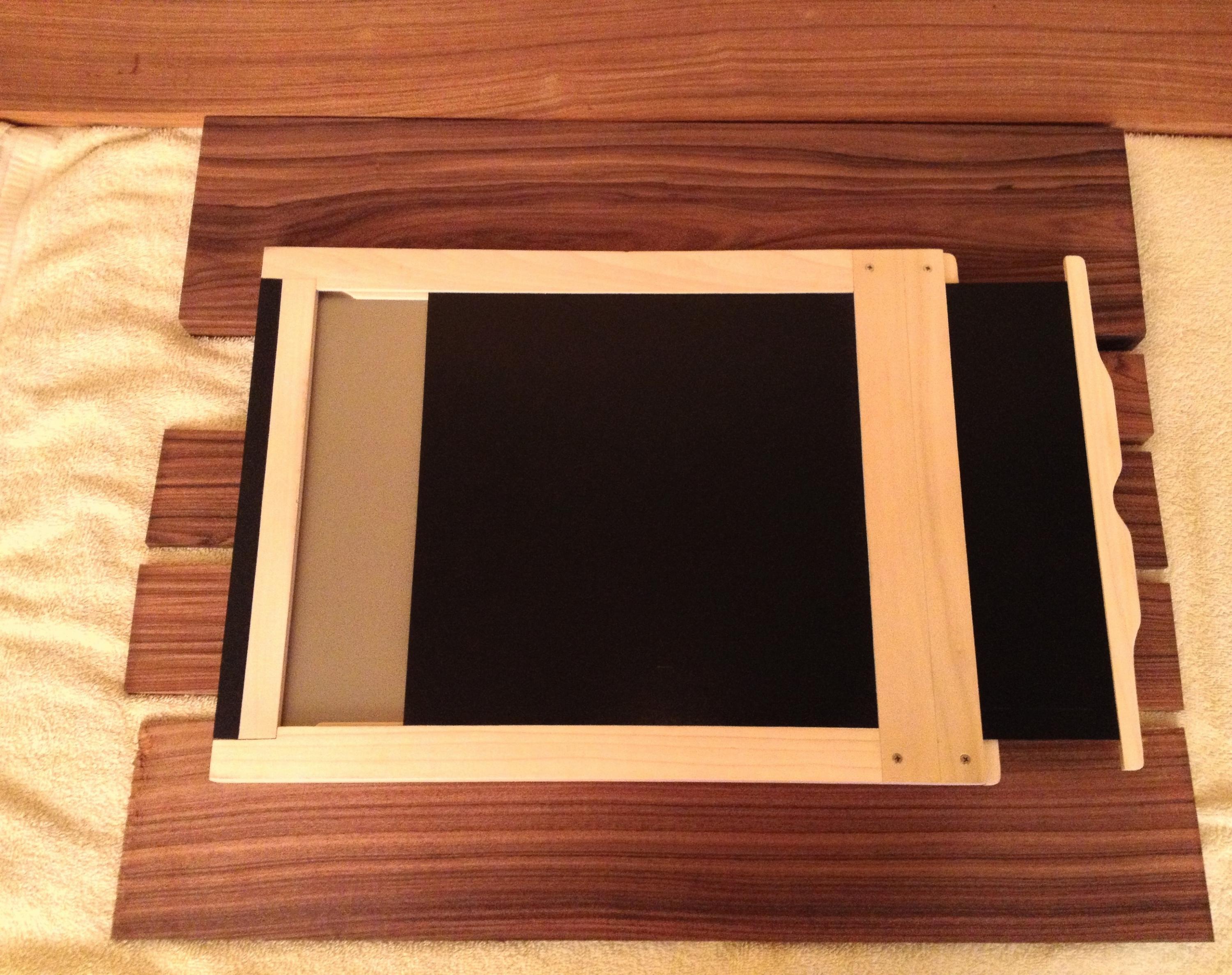

I am completing my camera build right now. Think Ebony in terms of basic design. I am making my own film holders also following the ANSI dimensions very closely. I have the hundred plus steps and procedures plus tooling done and have a holder made. Think traditional design, double sided wood holder. The camera and holders are are an extremely complicated design / build. I started the camera last April and it looks like I will be making film holders in the early summer. It is taking longer but I knew that going into this. The camera is made from Rosewood and Aluminum with manufacturing documentation. Not the home center aluminum. The hardware fasteners are stainless steel. The Ilex lens is going to be perfect for it. I have Artars also and others but this lens fits my needs better.
I am not sure I put a picture up on the holder. This is the prototype, notice there is no rib lock and the interior guides are not black. I plan to change the slide handle design and the final wood will be mahogany. Please note: I am not a film holder manufacturer and for those who ask I will not make them to sell. My focus is on creating images! Thank you for asking about the camera.
