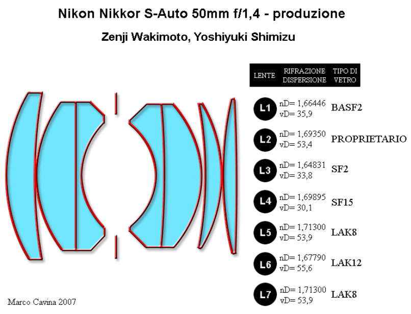

Source? It makes no sense, sorry. All manufacturers use or have used Flint glasses, those are common glasses. And all major manufacturers have used special types of glass, including high refraction index + low dispersion. Even on their normal lenses.
I'm surprised by you making such a statement, you're one of the most knowledgeable people on this forum...
PS: For example the common Nikkor-S 50/1.4
You can see there are many flint glasses used (common glasses)
And then two glasses of high index and moderate dispersion: LAK8, LAK12, and the "propiertary" glass.
Source: Marco Cavina
