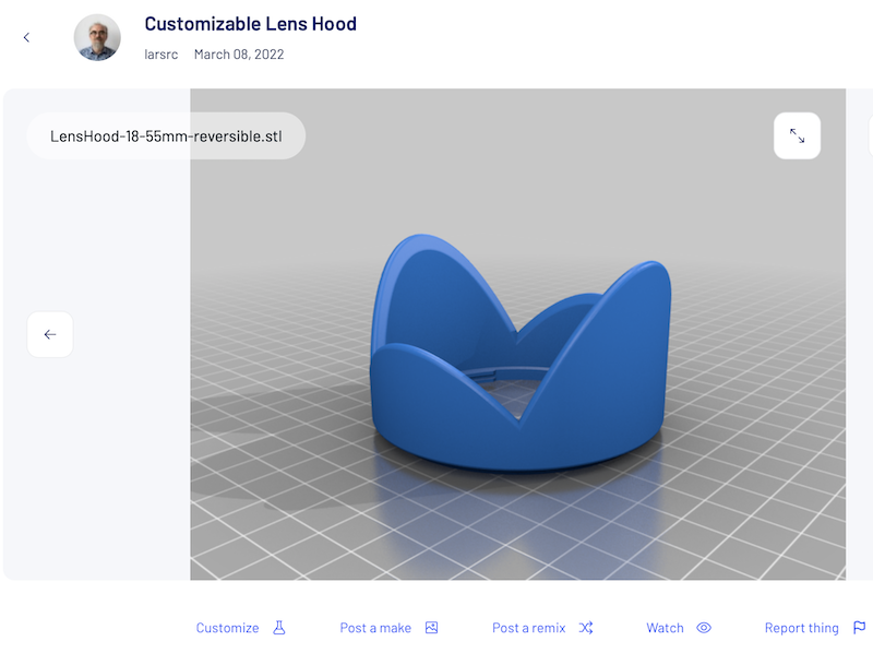

Have you checked Thingsverse?
I never bought a 3d printer because my community library does 3d printing for only the cost of the supplies.
