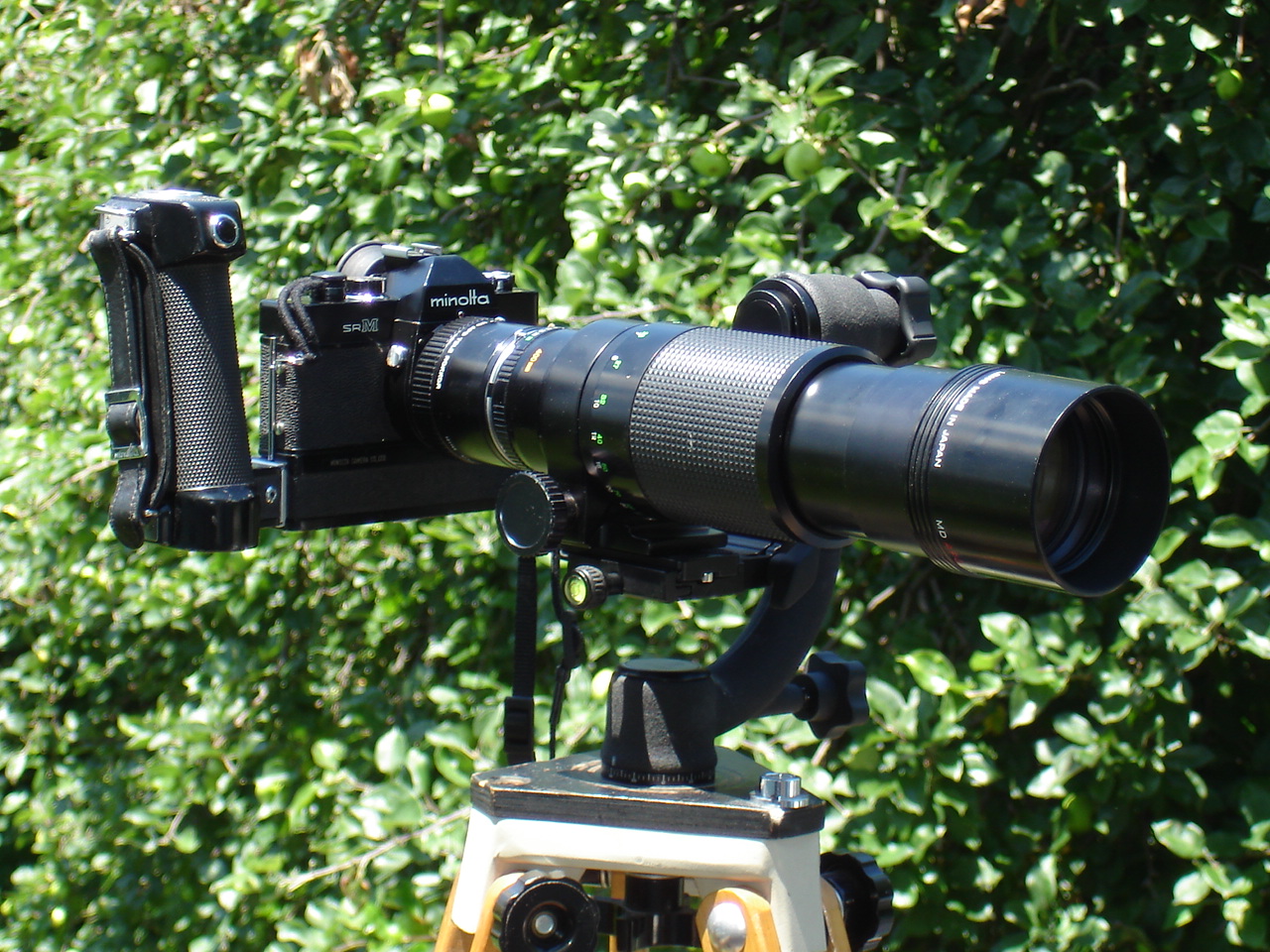

Here's my birding rig. Minolta SRM, 400mm f5.6 Apo Rokkor w/ Minolta Apo-2X, Gimbal Head, Zone VI lightweight tripod.

Here's my birding rig. Minolta SRM, 400mm f5.6 Apo Rokkor w/ Minolta Apo-2X, Gimbal Head, Zone VI lightweight tripod. View attachment 160315
The birds escape scared by that kind of anti-tank weapon!

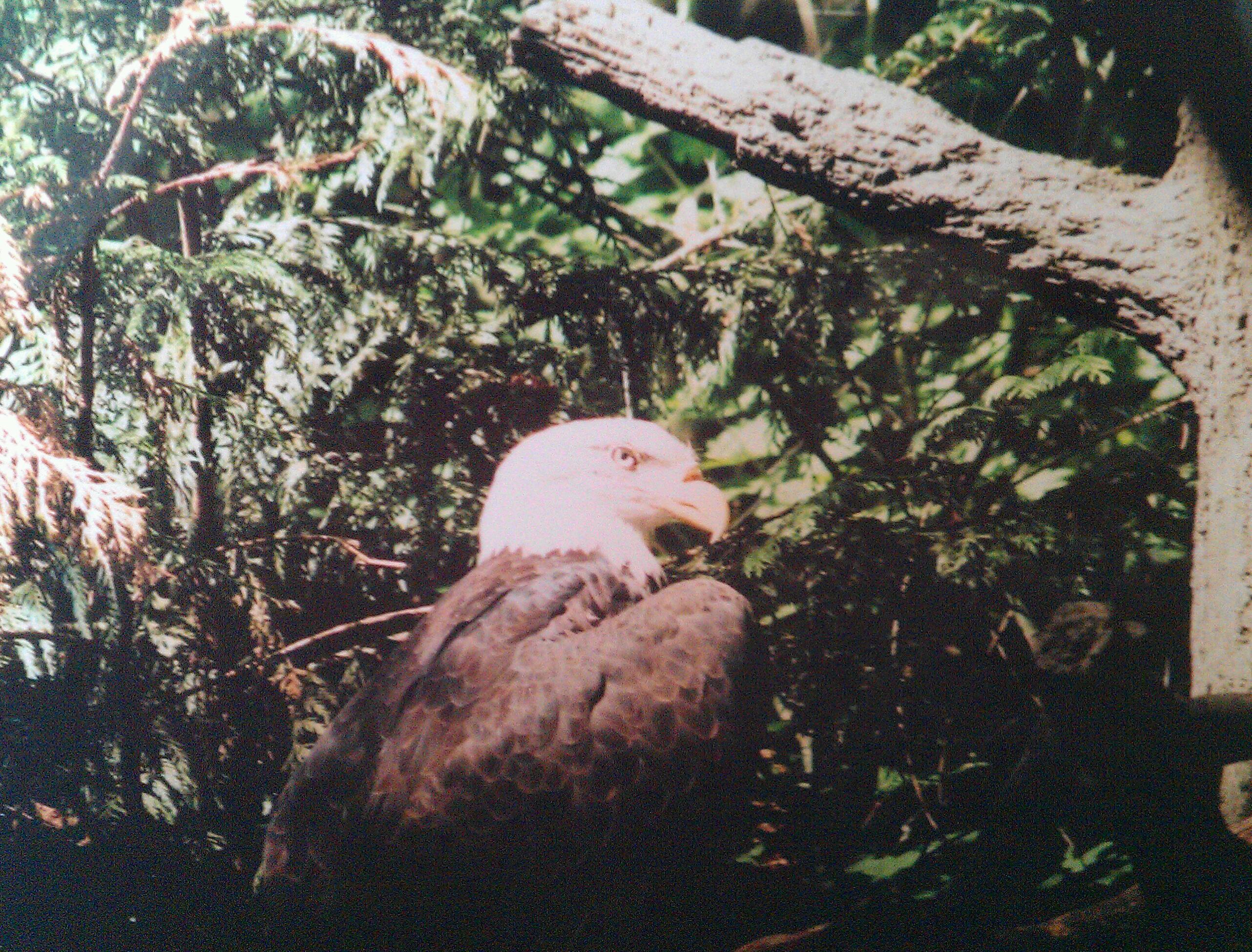

This is a zoo shot - actually a smartphone photo of a print.
The Bald Eagle was about 20' away, half shade, half sun. Shot with a Nikon F2 Photomic (not metered - no battery) and a 300mm f/4.5 pre-AI Nikkor. Kodak 200 film, f/5.6 and 1/60, handheld.
It was hard to get this because of the angle - my split prism kept going dark and so focusing was difficult.
