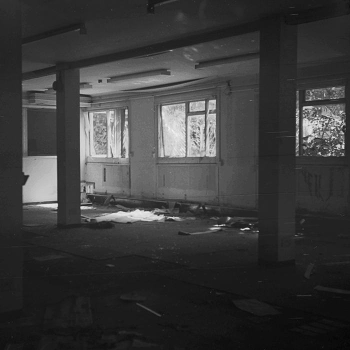

I used Pyrocat HD with Delta 400 and guessed exposures on an old folder.
This one was badly underexposed but Pyrocat gives a long scale and it was rescued after a fashion:
