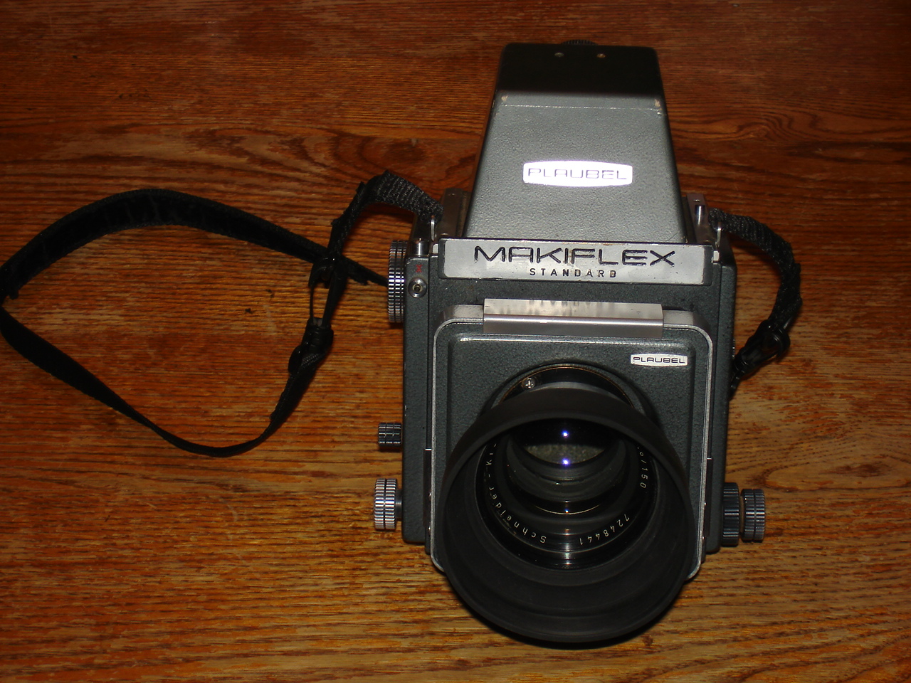

The point is that a pentaprism finder for a 6x9 format has never been manufactured until today.
Here is my Plaubel Makiflex Standard with 45 Degree Viewfinder.
I have lenses from 120mm to 360mm that fit it.
