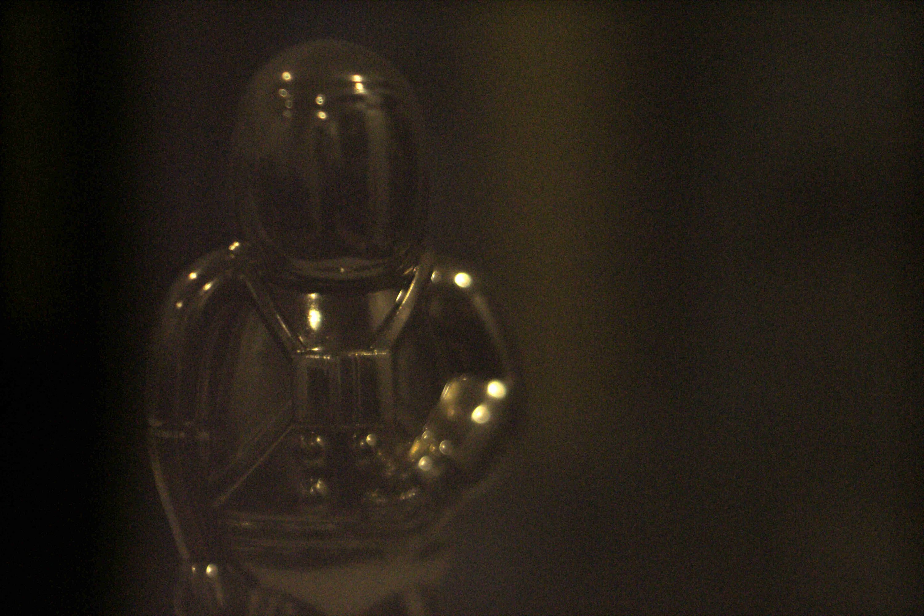

If you're looking for inexpensive options to experiment with, I've used a few older enlarging lenses as taking lenses. My 5 1/2" enlarging lens has served me well as a wide angle for large format. For medium format, you could shave a few inches and perhaps look for a vintage-looking 3 1/2" or 90/75mm lens. Another neat lens that I've used is the Industar-29 from Russia, which has more than enough coverage for 6x4.5 and the vintage look to go with it. Of course though, as a Soviet lens, it has a lackluster quality control reputation.
I took this sample photo wide open with my 5 1/2" Ilex Paragon Anastigmat f4.5 enlarging lens. There are books not 10 inches behind the spaceman that are completely blown out of focus. You'll have to excuse the terrible noise and exposure; I took this by hand holding the lens in front of my crop sensor.
