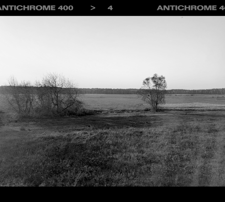

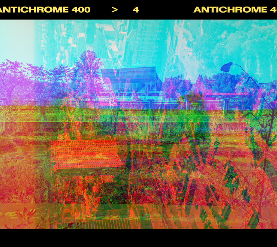

Mockup I made in Photoshop:

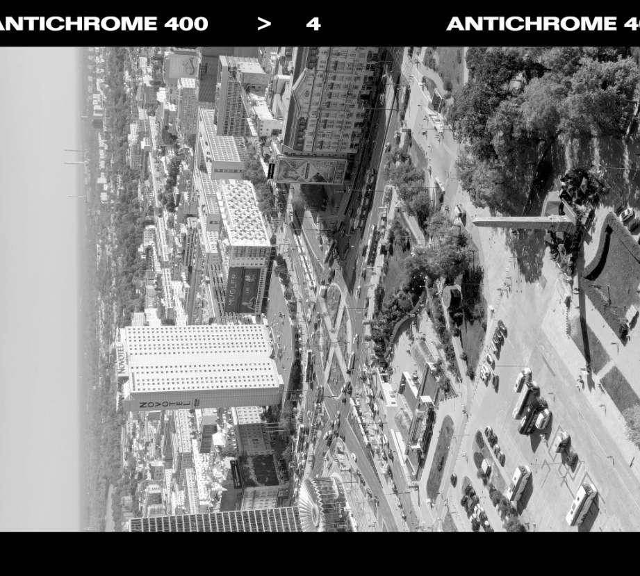

From which you can extract three B&W images:
But in principle it seems you could expose a single colour frame three times with different images filtered with R/G/B and then scan and extract each channel in photoshop to have separate B&W images. I imagine that given imperfections in various things here (the filters, the chemicals, the scanning setup, etc.), what you'd end up with is a muddy/messy result where channels bleed into each other a bit... but I bet it would look interesting. The orange mask might be a problem... maybe on Aero 100 cross processed in E6?
Your reasoning is sound as far as I can tell. Yes, there will be crosstalk between the images for the reasons you mention. And yes, it'll look interesting! The orange mask is not really a problem if you scan the film. Give it a try!
