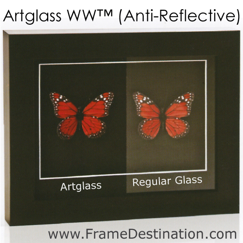

I agree Bob. I love to show local customers the demo box with the split regular and AR glass. Every time I tap on the AR glass they are surprised and say "wait a minute I thought there was no glass there". Of course the demo is a dark butterfly on a black back ground and black backgrounds are great at exaggerating the reflections. High key images with white mats are less of an issue with reflections.
