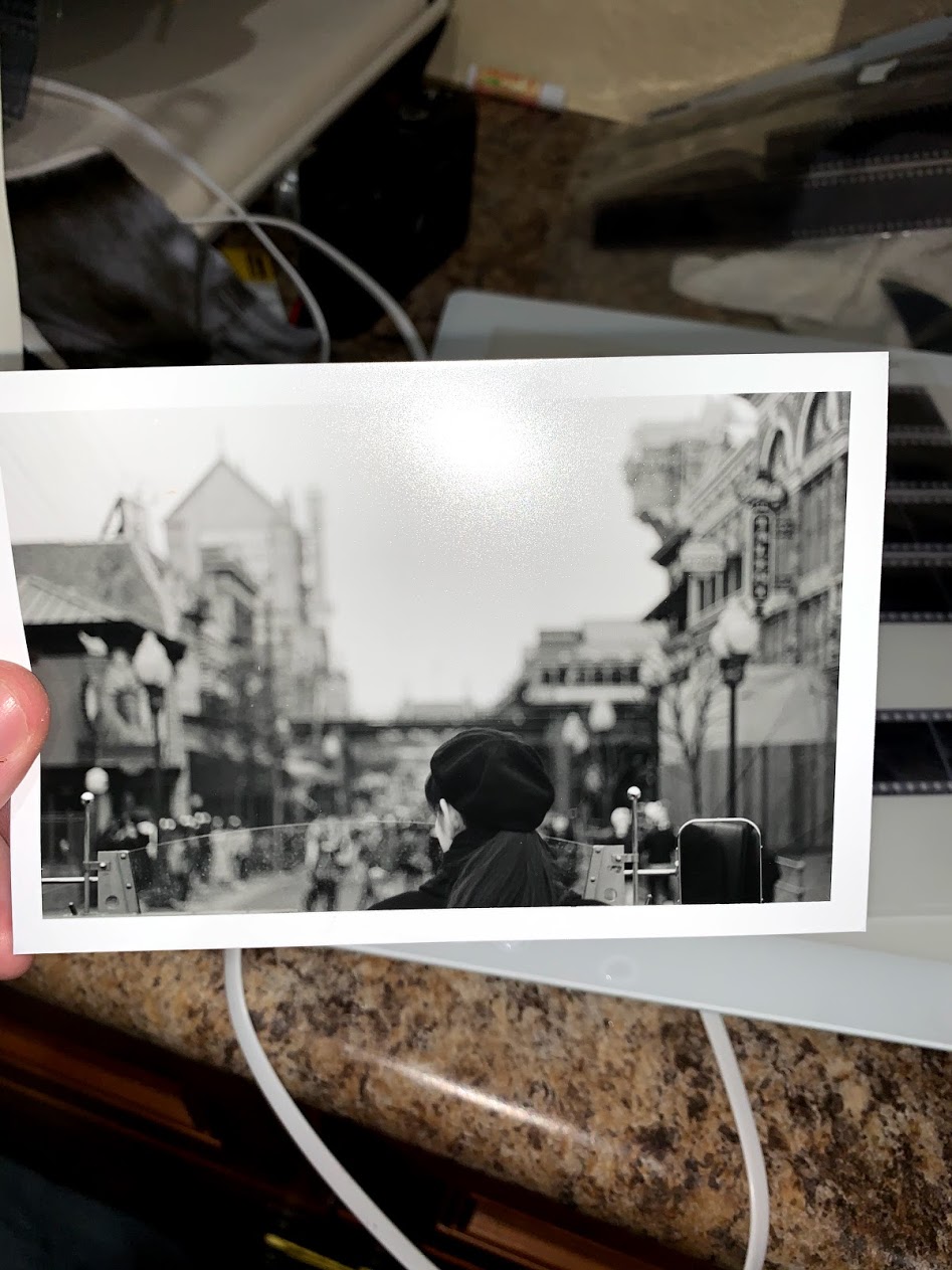

I'm working on a... unique formula for an environmentally friendly ascorbic-acid only developer. Basically something really designed so that you could mix it with things mostly from around the house. Current ingredients:
* ascorbic acid
* sodium oxalate (potentially optional, chelating agent, should help shelf-life and seems to prevent the pH shift that ascorbic acid radicals have. May regenerate ascorbic acid like sulfite does with other developing agents -- can also be substituted with easier sourced oxalic acid and appropriate amount of hydroxide)
* sodium carbonate (to make a buffer)
* sodium hydroxide (pH is ~12.5)
* potassium bromide (seems possible to replace with sodium chloride in the future to make it more "household")
However, I always get dingy borders unless I add benzotriazole. The developer is extremely eco-friendly aside from that addition. It also produces very nice distinctly cold tone results with very deep blacks and seems to last a few hours once the alkali is added. However, without the benzotriazole I always get dingy borders with either warm orange fogging with just a little bromide added, or more subtle grey fogging with a surplus of bromide.
Is there any eco-friendly and preferably "household" ingredient that can be used here? I've observed that oxalate can in some cases behave like a very weak anti-foggant, but not to the extent needed without a very large amount, an amount requiring the higher solubility of potassium oxalate which is a lot harder to source and of course more expensive. I plan on keeping the final solution in 2 parts, the ascorbic acid is kept naturally acidic which seems to keep on the shelf significantly better. I've also tried using lower alkalinity, but all tests thus far toward that were not good (10m+ dev time and with weak blacks).
And before someone says it, yes, I know I could add a smidge of phenidone and probably have something that works great at lower alkalinity and with less fogging tendency. I'm just trying this for purely experimental and creative purposes and because I've never seen a suitable ascorbic acid only print developer. The results are also very nice and somewhat variable contrast/exposure due to how shadows develop. Definitely colder tones than I've seen from pretty much any cold tone developer I've tried, with or without the benzotriazole. Example print attached (Ilford MGIV portfolio postcard paper)

That was what I was looking through but ultimately just decided it was impossible. In tests it required massive amounts of benzotriazole and bromide to completely prevent fog across a range of papers... and then the results were abysmally slow. One interesting workaround is that you can over expose and not develop to completion (blacks will completely darken long before highlights are there) to avoid the fog, but it’s basically all the pains of lith printing with none of the benefits at that point, though it does allow for some interesting amount of contrast control.
regardless, I’ve decided to use my remaining “part A” developer stock in formulating a more typical phenidone-ascorbic print developer, which has been extremely successful. I’m letting the tray sit out overnight, but thus far it has lasted 5 hours with no change in activity and only a very minor change in overall tone (shadows slightly more open when aged). The solution is a pale distinct pinkish orange color however where it started out as clear. It is otherwise a neutral tone, slightly elevated shadow contrast, and very fast print developer that is complete within 1 minute for RC papers and 2m for FB paper, even after 5 hours of sitting in an open tray
