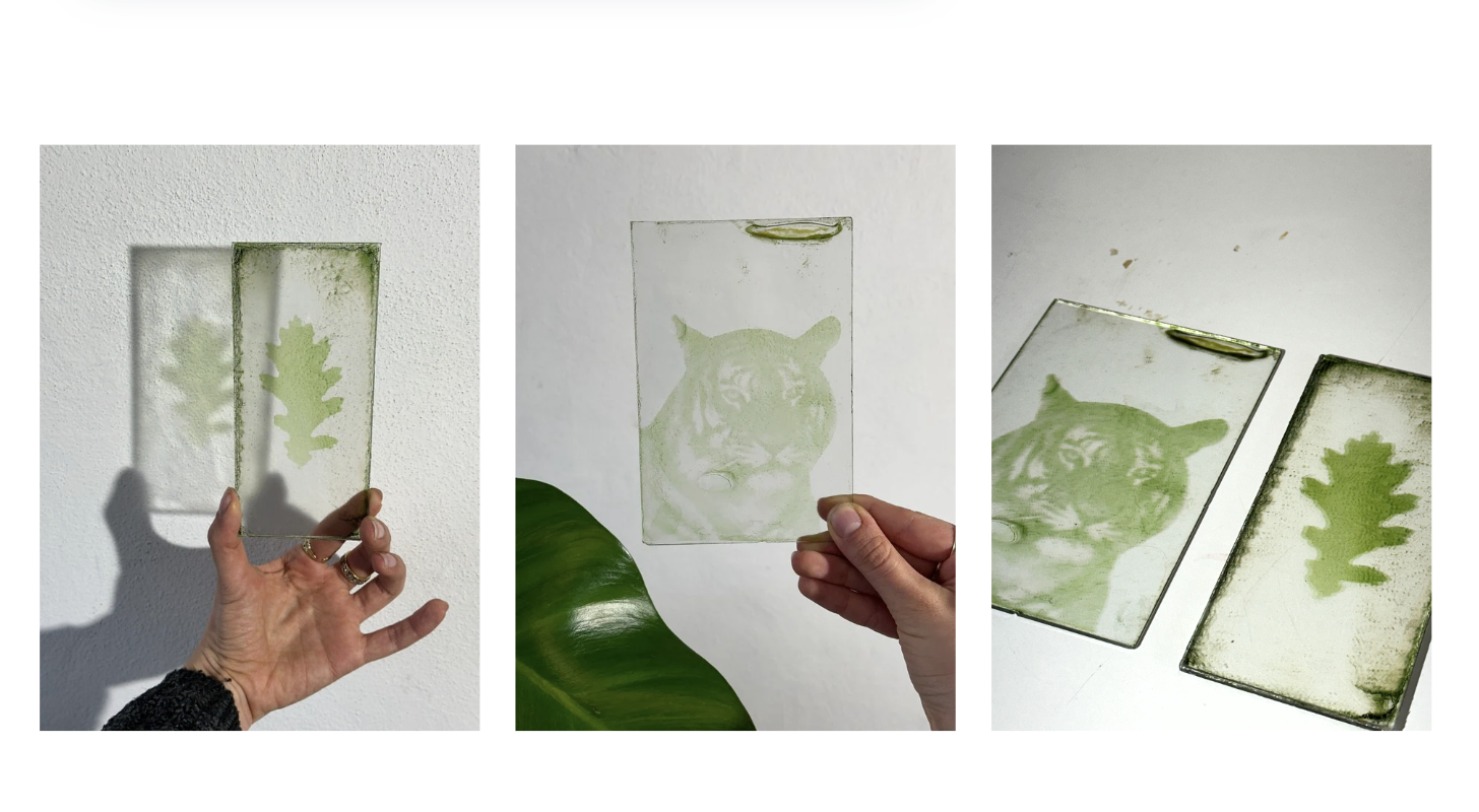

Hi! I've been printing anthotypes on glass for a while using agar as a substrate! Here's an example, this is spirulina
